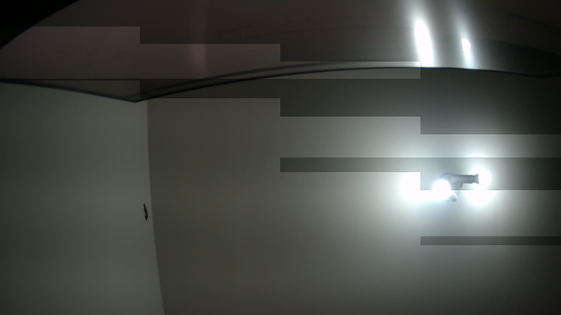

Hello, when i read images with gstreamer from a imx477 camera connected to the mipi cam0 connector, i get a very visible tearing line trough the image, the gstreamer pipeline used is:
gst-launch-1.0 nvarguscamerasrc ! ‘video/x-raw(memory:NVMM), width=1920, height=1080, framerate=60/1’ ! nv3dsink
and here is an screenshot from the camera feed to show the issue:
The issue persists in different resolutions and frame-rates and my monitor is set to display at 60hz
Any ideas on where/what the issue could be? I already ran the jetson-io script multiple times to configure the pin layout for the connector, tried multiple cameras, multiple cables and multiple jetsons
I’m using a Jetson Orin Nano JetPack 6.2 with the tensortRT and gpu drivers installed trough sdk manager. the issue is the same for jetpack 6.1 as well

I understood now what you meant, boosting the clocks for the camera did not work, the frame tearing is there, and it is there for video and photos with the IMX477 camera.
Could you get the raw image by nvargus_nvraw?

The test.raw file is always saved as empty, i added the --verbose flag to read what was happening, and got this:
v4l2-ctl --verbose -d /dev/video0 --set-fmt-video=width=1920,height=1080 --set-ctrl bypass_mode=0 --stream-mmap --stream-count=1 --stream-to=test.raw
VIDIOC_QUERYCAP: ok
VIDIOC_S_EXT_CTRLS: ok
VIDIOC_G_FMT: ok
VIDIOC_S_FMT: ok
Format Video Capture:
Width/Height : 4032/3040
Pixel Format : ‘RG10’ (10-bit Bayer RGRG/GBGB)
Field : None
Bytes per Line : 8064
Size Image : 24514560
Colorspace : sRGB
Transfer Function : Default (maps to sRGB)
YCbCr/HSV Encoding: Default (maps to ITU-R 601)
Quantization : Default (maps to Full Range)
Flags :
VIDIOC_REQBUFS returned 0 (Success)
VIDIOC_QUERYBUF returned 0 (Success)
VIDIOC_QBUF returned 0 (Success)
VIDIOC_STREAMON returned 0 (Success)
cap dqbuf: 0 seq: 0 bytesused: 24514560 ts: 796.988572 (error, ts-monotonic, ts-src-eof)
cap dqbuf: 1 seq: 1 bytesused: 24514560 ts: 797.025333 delta: 36.761 ms (error, ts-monotonic, ts-src-eof)
it seems the camera is outputting 4032 x 3040
the issue persists with the raw image
Hello @joras,
Thanks for sharing back the results, they are very helpful.
If the issue persists with raw capture, it means that is not related to nvargus capture subsystem or the ISP.
And, given that the imx477 driver is supported by default by NVIDIA boards and its already tried and tested, I would doubt could be driver related. Well, unless you are using a driver from somewhere else, but I don’t think that is the case, right?
Then, the next tests we would suggest trying are:
  1. Try changing CSI ports.
  2. Try changing MIPI cables.
  3. Try changing camera modules.
This would help us debug if this could be a HW issue.
best regards,
Andrew

Hey @joras,
Sure, no problem, it’s our pleasure to help.
Roger that, so yeah essentially a HW issue is ruled out.
Given that arducam has a driver that fixes the tearing issue, my next guess would be something related with timing or padding. Based on our experience that is usually the cause of issues that show like the one you are experiencing.
I was trying to look for the source code of that arducam driver you mentioned, but unfortunately it seems like they only provide a Debian package. Do you happen to have its source code ?
If not, a couple tricks I would try to get more information about it would be:
  1. Check DTB configuration inside /opt/device-tree.
  2. Try checking register table values by getting register addresses from the IMX477 camera driver that you do have source code for, and reading the registers manually with i2cget while using the arducam driver.
I would also suggest contacting arducam to see if they can provide the source code.
Please keep us posted, and do not hesitate to reach out it you require further support, we would love to give you hand.
