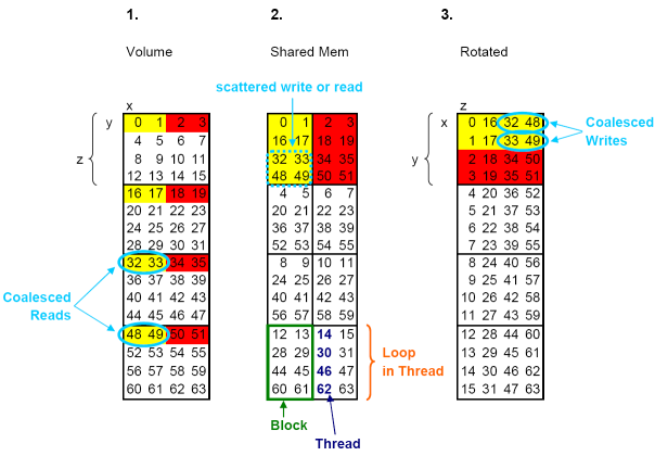

I implemented a simple index reshuffling with CUDA. It can shuffle XYZ into ZXY. It outperformed my naiv implementation on the CPU by a factor of 10 (measured without data transfer overhead). A volume with over 13 million bins can be reshuffled in 10ms.
Here’s an image that explains the idea:
Basically the data from the source volume is read “as coalesced as possible” into shared memory and then written also “as coalesced as possible” to the target volume.

Do you manage to write the code in a way that all the data will be horizontally coalesced into the block of memory instead of 2-by-2? I think it shouldn’t be too hard to implement that, but I am not sure.
It can be done if the volume is small enough. The data read by one block has to fit into shared memory (16KB per multiprozessor or block).
My idea was to try to make both the reads and writes coalesced and the best way to do that is to make the intermediary data in shared memory square or almost square.
This looks rather like a 3D extension of 2D matrix transpose. The same method (SMEM as a staging area) is used in the “transpose” SDK example if you want a simpler example to start from.
