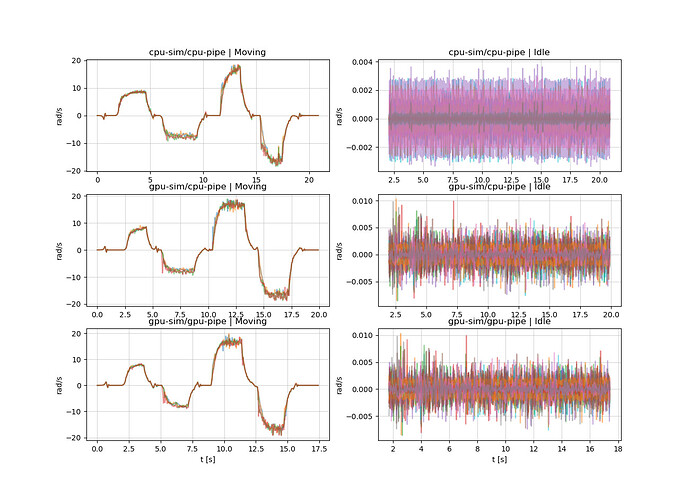

I tested the CPU/GPU combinations, as suggested. Some details before the comparison:
  • the DOFs here refer to wheels on a 4-wheeled robot (with each wheel independently actuated),
  • there are multiple robots in the simulation, of which one was controlled by me (4 DOFs moving back and forth at two different torque magnitudes) and the rest were idle (4x7 idle DOFs),
  • for now, the terrain is a simple plane, but more complex, sloped terrain might be tested in the future,
  • PhysX backend is used for simulation and the tensor API is used for reading the DOF state tensor and setting the DOF actuation tensor.
In the images from the original post, the simulation and pipeline were both on CPU. Here is the comparison:
Notes:
  • the idle plots are cut off at the beginning due to an initial a spike which ruined the scale of the plot (values went to about 1.5 rad/s as the wheels settled, though the visual effect did not seem that extreme),
  • the magnitude of the noise while idle seems a bit smaller with CPU simulation,
  • the noise patterns while idle seem identical on repeated runs with GPU simulation.
