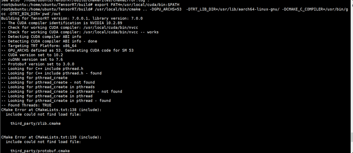

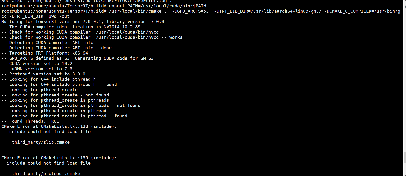

Include could not find load file: third_party/zlib.cmake
When I deployed tlt to deepstream, I encountered the following error. During the Build TensorRT OSS process, I encountered the cmake error as follows:
Please build the OSS plugin in Jetson device directly.
It has been resolved, tensorrt oss should download version 7.1 instead of the default version 7.0.
