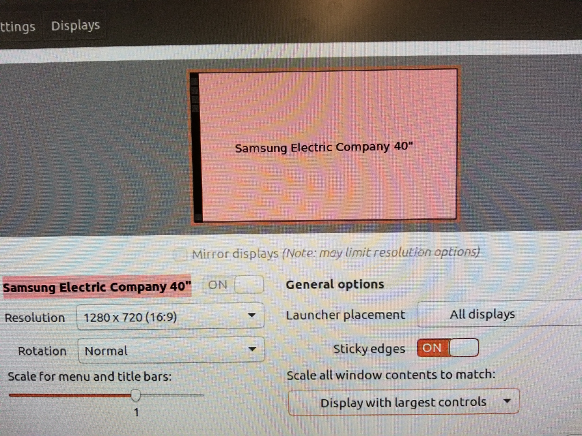

incorrect monitor and resolution detection from xavier B hdmi
We received a repaired drive agx Xavier devkit from nvidia. We connected a monitor to xaver A hdmi port 0, and it was detected correctly as a Dell p2717h in 1920x1080 resolution, while the same monitor connected to Xavier B hdmi port 0 was always incorrectly detected as an Samsung monitor in 1280x720, and there is no way to switch to 1920x1080 resolution. The problem remains, regardless of what other monitors or HDMI cables were used. I also re-flashed the firmware using SDK manager, the problem remains unchanged. Please advise. Attached please see the pictures for Xorg.log from both Xavier A and B, and also the monitor setting from Xavier B.
Besides, I also notice i2c kernel errors message from Xavier B Linux, not sure if it is related to the resolution issue.

… tegradc 15200000.nvdisplay: hdmi: edid read failed
… tegradc 15200000.nvdisplay: hdmi: using fallback edid

By the way, I guess i2c failed to read edid. Is there a workaround to tell kernel to use a customized edid instead of the fallback edid?
