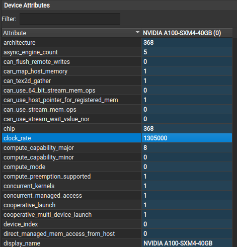

The roofline is constructed based on the clock rate at which the application was run (because that sets the upper limit).
What is the _clock\_rate_ for your profiling run? You can find this under _Device Attributes_ on the _Session_ page in the Nsight Compute UI.

Thanks for the answer @Sanjiv.Satoor , I’m really interested in correctly interpreting this chart. The reported clock\_rate for my A100 was: 1305000
![clock_rate](https://global.discourse-cdn.com/nvidia/original/3X/e/0/e0504fd33f5676f3ee6da6a03bea3ab2cd7cf548.png)
How is that clock\_rate used to compute the FP boundary? Could you share that formula? I’m guessing the 9.5 TFLOP/s peak would then require some GPU Boost Clock?

I’ve figured it out. This has to do with the clock control option on Nsight Compute and the default application clock that’s set on the A100 I’m running on (1305 MHz). I should then set the clock rate through nvidia-smi and then profile the application with no clock control.
> **[Kernel Profiling Guide :: Nsight Compute Documentation](https://docs.nvidia.com/nsight-compute/ProfilingGuide/index.html#clock-control)**
> Nsight Compute profiling guide.
However, this still doesn’t add up the 7.5 TFLOP/s boundary that plot is showing. How is that peak boundary computed using the clock rate?

Please refer the reply posted here: [About the flops in ncu report - #6 by Sanjiv.Satoor](https://forums.developer.nvidia.com/t/about-the-flops-in-ncu-report/215350/6)
