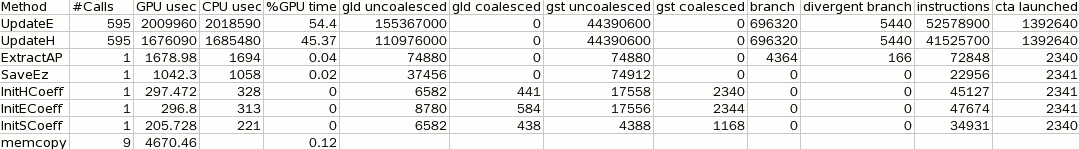

thanks for the reply. I am not sure if this deceleration is due to indexing or my un-wised use of the global memory (frankly, I have no idea what are the griddim and blockdim that I should use). maybe you can help me determine a reasonable number based on your experience:
my domain size is 512x512, there are a couple arrays of that size, some of them are coefficients (float4), some of them are the field qualities (float2/float4). For each kernel, I do a finite difference calculation, which normally requires to get the neighbor values and do some simple algebra, for example, one of my kernels look like (and you can see my ugly indexing calculation)

I attached the output from CUDA visual profiler (as a figure), I don’t know if these numbers mean anything to you.
The biggest problem I see with your code (in Step2) is the use of a lot of uncoalesced global memory accesses (look at the gld uncoalesced column in your visual profile, especially for UpdateE and UpdateH)). The best thing to do is to access swaths of contiguous memory, even if you don’t use all of the values! Gaps in the fetches or stores give the GPU a severe case of the hiccups.

Indeed, what kills your performance is uncoalesced memory accesses (both loads and stores). Coalescing mem accesses should be #1 when you optimize. I’d wager that #2 would be getting rid of divergent branches (if you can, maybe they’re caused by border conditions and have to be there?). Read up on that, it can be quite a difficult topic.
