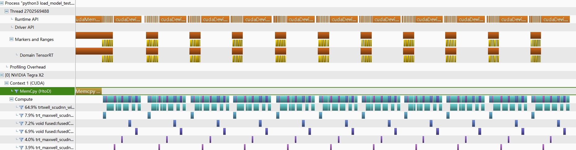

I am working on deploy models on TX2
The model is ok on desktop.
On TX2, If the engine is builded without EXPLICIT_BATCH, everything is still fine. But if I build engine with EXPLICIT_BATCH, Inference is much slower than pytorch.
I have add some IPluginV2DynamicExt in my model, If I can’t use explicit batch, all these plugins have to be rewrited.
Is it possible to speed up the engine?

thanks for reply.
I have already add the profiles, still slow. Fix the input shape not working too.
for resnet18, pytorch 0.018ms vs trt 0.23ms
My model is an end2end faster-rcnn, The input batch size is 1, After roi pooling, there are 1000 features feed to rcnn. The batch size has changed. That’s why I use explicit batch. How can I make it work in implicit batch?

I think I found something related.
I use the nvprof follow your advice, and found some HtoD memcpy while trt inference, guess that’s sychronize the stream.
But i still have no idea why this happened.
explicit batch
implicit batch
I try to run your code on my machine v100 system with TRT 7 and got following result:
model test
pytorch take time: 0.0034534454345703123
trt take time: 0.0007956743240356446
I even checked the code that you shared, it user torch2trt but not able to find explicit and implicit case. Could you please share the script/steps to reproduce both the cases?
