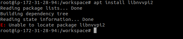

Hi, Thank you for replying to me. I have tried to install arm64.deb file from this link DeepStream | NVIDIA NGC
but it required me to install the libnvvpi2. But I cannot install the library although I already added the apt repo
FYI: there is not Docker image for version 6.3, only version 7.1 has docker image for arm-sbsa
Which version of Ubuntu did you install?
Please follow the instructions to install Ubuntu 22.04 and DS-7.1. CUDA and TensorRT must also be installed with the specified version, otherwise they cannot be guaranteed to work properly
DS-6.3 has not been tested on ARM64 SBSA and vpi2 is no longer supported.
