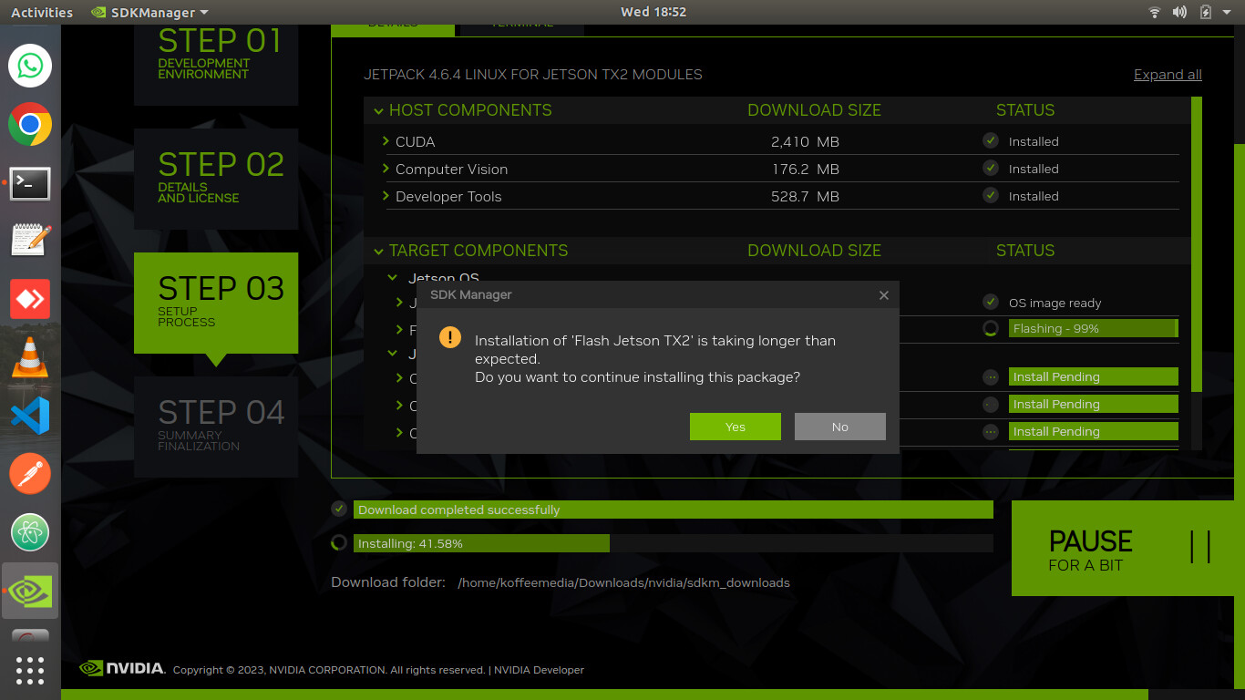

Installation of flash jetson tx2 is taking longer than expected on jetpack 4.6.4
when i tried to install flash jetson tx2 using sdkmanager jetpack 4.6.4. it is showing the message as it is taking longer than expected. i am using ubuntu 18.04 and i tried different USB which are having data transfer capacity. but i am getting the same result. it always stopping at the 41.58% of flashing

there is a export logs button on sdkmanager. Pause the flash and dump the log.
It may tell what is going on.
i am attaching the log file please help me
SDKM_logs_JetPack_4.6.4_Linux_for_Jetson_TX2_modules_2023-09-20_18-24-35.zip (154.3 KB)
Not much clue from the host side log.
If this is NV devkit, please follow this page to dump the flash log from device side.
