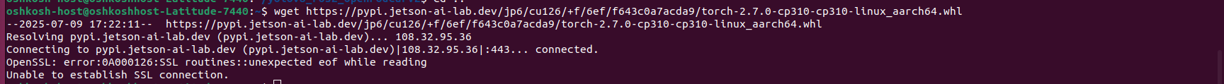

And yesterday jp6/cu128 had the status not found .
Please fix this (pypi.jetson-ai-lab.dev and add back the jp6/cu128 index)

Has the issue been fixed cause I am still receiving when trying to install torch 2.7.0 for my Jetpack 6.2
Two different errors.

there is a Nvidia pypi backup until new host comeback:..
pip3 install torch —index-url https://pypi.jetson-ai-lab.io/jp6/cu126
Awesome. Thanks so much johnnynunez
I was able to download the WHL file from jp6/cu126 index . Thank you so much johnnynunez!
FYI - If you don’t have sympy (or any other dependencies) pre-installed when installing PyTorch from the pypi backup URL jp6/cu126 index , it will look for them on pypi.jetson-ai-lab.dev/ and fail.
Suggest downloading separately from GitHub and using --no-index on the pip install.
