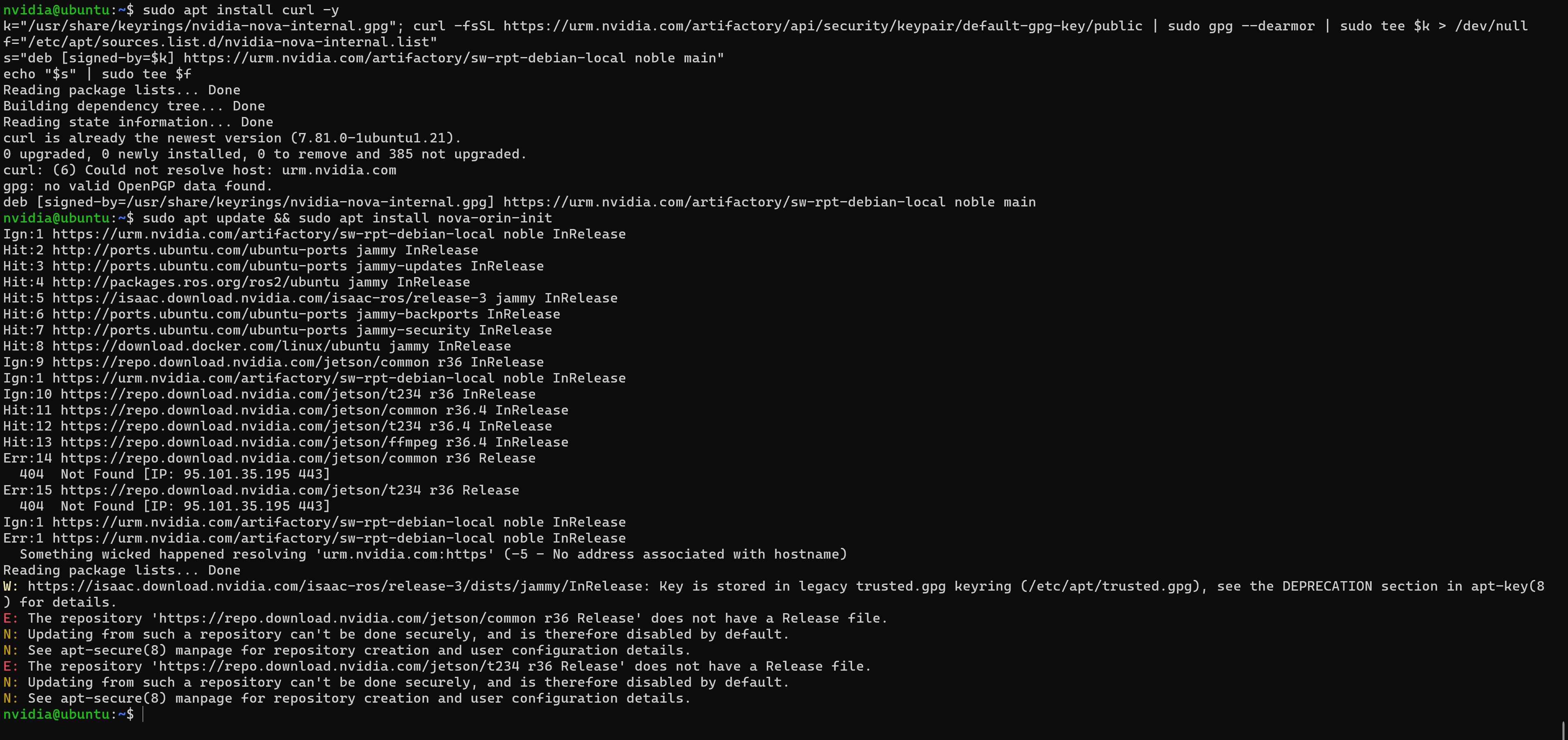

I am trying to install Nova Orin Init from Nova Orin Init — nova_docs documentation , and I get the following error:
How can I proceed and install Nova Orin
Hello @Lefkios,
Please ensure your system can connect to the internet first.
Then try the curl command again. If you still see this error “no valid OpenPGP data found“, you can also manually download the gpg key.
It was connected to the internet. This was through an ssh connection.
I also tried running it while it was connected with an ethernet cable. Still the same error.
How do i manually download the gpg key?
My system has working internet and DNS resolution (ping tests successful):
I Attached is a screenshot showing successful ping to both google.com and 8.8.8.8:
It looks like only urm.nvidia.com specifically fails to resolve.
Hi @Lefkios ,
Infomation update, the Nova Orin Init — nova_docs documentation has been recently updated for the new release(JP7.0), and the support for older versions doesn’t seem to be available for now.
Please follow below commands for JP6.0 setup:
  • Add the correspond apt repostiory:
k="/usr/share/keyrings/nvidia-nova.gpg"
curl -fsSL https://isaac.download.nvidia.com/nova-init/repos.key | sudo gpg --dearmor | sudo tee $k > /dev/null
f="/etc/apt/sources.list.d/nvidia-nova.list" && sudo touch $f
s="deb [signed-by=$k] https://isaac.download.nvidia.com/nova-init jammy main"
grep -qxF "$s" $f || echo "$s" | sudo tee -a $f
sudo apt-get update
  • And install nova-orin-init with specific versionn:
sudo apt install -y nova-orin-init=1.3.1
