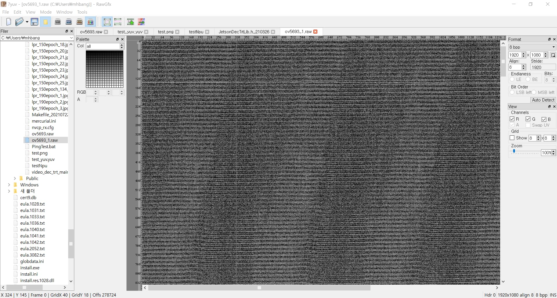

Is there a way to capture with v4l2-ctl using tx2's onboard camera, ov5693? It's in BG10 format, but how do I check if the raw image comes out?

Save to file by below command and use tools to check it. However need to check how the raw data in VI pixel memory layout from the TRM.
v4l2-ctl --set-fmt-video=width=1920,height=1080,pixelformat=RG10 --set-ctrl bypass_mode=0 --stream-mmap --stream-count=1 --stream-to=ov1080.raw -d /dev/video0
I am checking the output raw image file at rawpixels.net.

Yes, you should change it BG10 and I would suggest to use 7yuv to check it.

v4l2-ctl --set-fmt-video=width=1920,height=1080,pixelformat=BG10 --stream-mmap --stream-count=1 -d /dev/video0 --stream-to=ov5693_1.raw
save it with the above command
I checked it like below using 7yuv.
How do I make adjustments to get an accurate image?

After adjust the width/height even 8 bpp should be able see the image.

Have a try this command. Add --stream-skip=30
v4l2-ctl --set-fmt-video=width=1920,height=1080,pixelformat=BG10 --set-ctrl bypass_mode=0 --stream-skip=30 --stream-mmap --stream-count=1 --stream-to=ov1080.raw -d /dev/video0

I adjusted the Bits and it came out like this.
But I want it to come out perfect.

Could you try 2592x1944
Get the 2592x1944 raw image and adjust the align to 128 in 7yuv configure.

What’s your version? The stride should be 2688
