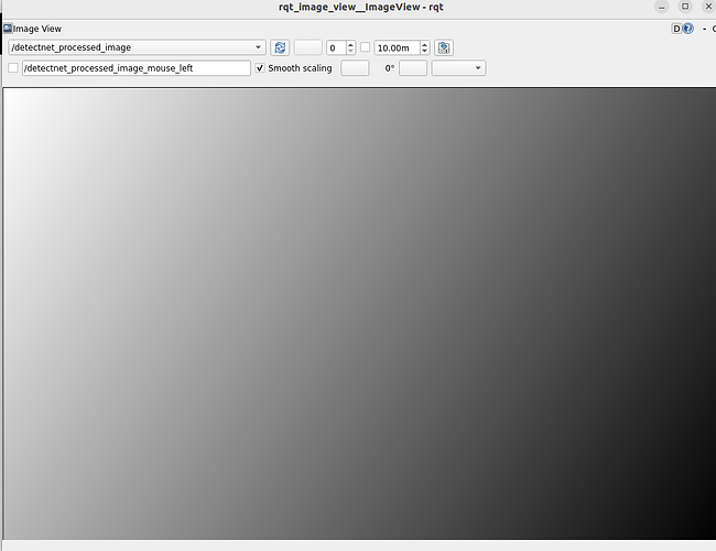

Thanks for your advice.
realsense2_camera node can works now.And I had confirmed that my cam is working:
However, I still can not get processed img,it is still blank.
Here is log:
log2.txt (56.3 KB)
Hi @lzjie ,
Are you using JP6.0(+Isaac ROS 3.1) or JP6.2(+Isaac ROS 3.2)?
Did you run the command “ros2 run rqt_image_view rqt_image_view /detectnet_processed_image” to visualize the output?
( Please refer to isaac_ros_detectnet — isaac_ros_docs documentation )
According to your attached picture, looks it’s using the wrong image view.
Please help to change the upper left corner box from “/color/image_raw/compressed” to “/detectnet_processed_image” to see if it works.
Thank you.
I am using JP6.0(+Isaac ROS 3.1).
I just want to use that pic indicate that my cam can normally captured images.
When I change to /detectnet_processed_image,it is still blank like before.
Hi @lzjie ,
Thanks for your quick update.
I took a moment to verify this sample on my end and everything works fine.
Could you please help to check the Realsense firmware version is matched to the requirement( v.5.13.0.50) and try it again?
It is required to use RealSense firmware version 5.13.0.50, librealsense version 2.55.1 and RealSense camera ROS driver version 4.51.1. Any deviation from these versions will break Isaac ROS examples.

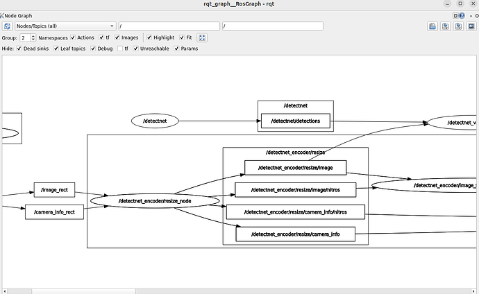

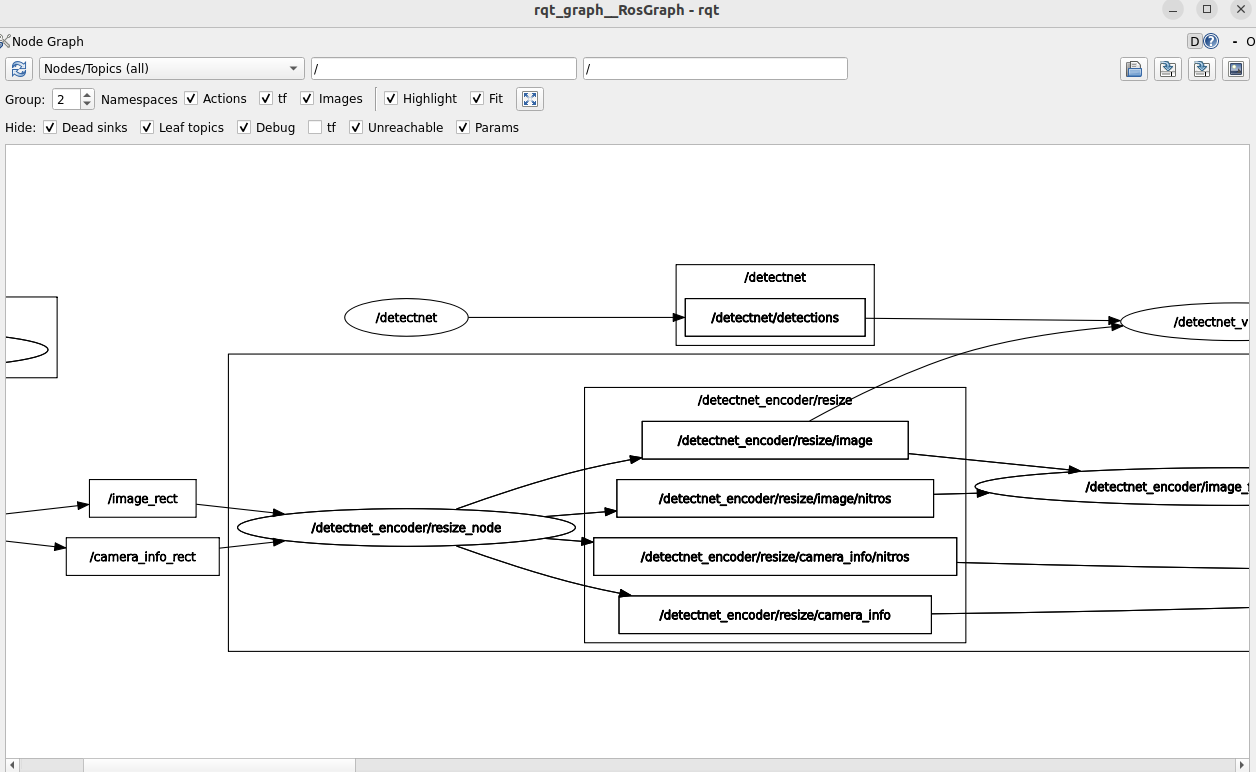

Hi @nvidia_user_1234 Team,
I’m also facing the same issue as described in this thread when using Isaac ROS DetectNet.
🔧 System Setup:
[list]
JetPack Version: 6.2
Isaac ROS Version: release-3.2
Platform: Jetson Orin NX
Sensor: Intel RealSense D435i
Firmware Version: 5.13.0.50
🧪 Issue:
The pipeline launches successfully without any critical errors.
However, the /detections topic from detectnet_decoder_node is either empty or not publishing proper detection results.
The image stream from the D435i camera is valid and visible on /image_rect.
✅ What I’ve Tried:
Verified camera feed and camera_info topics via rqt_image_view and [code]ros2
Thanks in advance for your support!
— Abhishek
Hi @chaud324 ,
Thanks for your post.
Somehow the attached rosgraph is with bad resolution, and we can see there are no data sent to /detectnet in attached image.
Could you please provide the clear picture of rqt_graph and execution logs?
