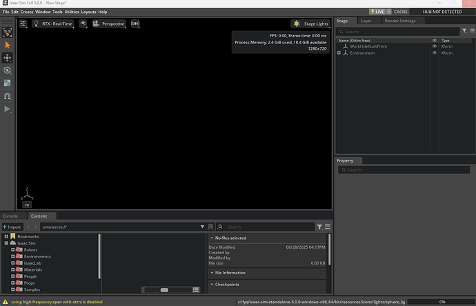

Isaac Sim 5.0 and 4.5 on Windows 11 hangs at 0% (“icons/lights/distant_light.png”)

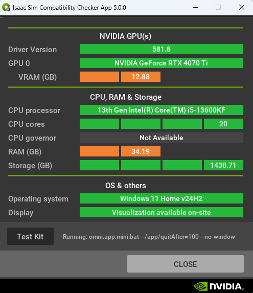

GPU Information
  • Model: NVIDIA GeForce RTX 4070 Ti
  • Driver Version: 581.08
  • CPU/RAM: Intel i5-13600KF, 32 GB RAM
Topic Description
Isaac Sim startup hang at “icons/lights/distant_light.png”; local Nucleus installed/running but UI stalls at 0% (sometimes crashes)
Detailed Description
On my new Windows 11 PC, Isaac Sim consistently stalls during startup: the bottom status bar remains at Loading… 0%, often with the last printed asset being .../icons/lights/distant_light.png.
What I’ve Tried
  • Launching with --reset-user --reset-data.
  • Clearing caches: removed/renamed user cache/extension folders under
    C:\Users\<USER>\AppData\Local\ov\data\kit\Isaac-Sim Full\5.0\ (and 4.5 if present),
    plus deleting the temporary portable root directory before relaunching.
    none of them works however…
Additional Context
  • Only one time, replacing distant_light.png appeared to “work once” (isaac sim launched successfully), but it doesn’t work anymore…
