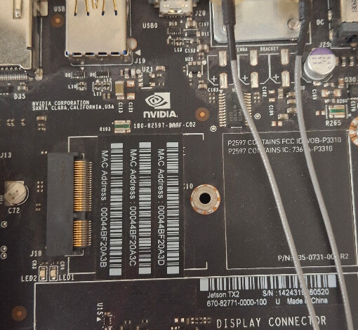

The documentation indicates UART3 is on the M.2 Key E Connector. This connector is used for the followings:
▪ PCIe x1 Lane, SDIO (Jetson TX1 only), USB 2.0
▪ I2S, UART, I2C, Control
Reading through the JetsonTX1_TX2 Developer Kit Carrier Board Specification, documentation. It presents the UART to be Pin 22 from [J18] which is a M.2 Key E Connectivity Socket (75-pin). I do not have M.2 Key E connector experience. What is the proper adapter to acquire to plugin the M.2 Key E connector? The picture looks a bit different.
Best Wishes,
