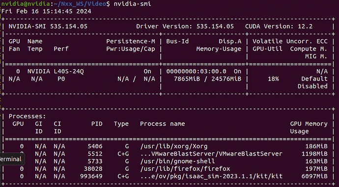

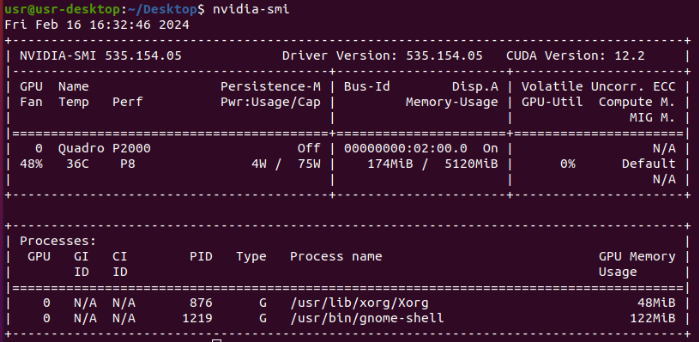

I succeeded to run IsaacROS demo (visual_slam & nvblox) on Ubuntu-PC(Ubuntu 20.04) with like below GPU(P2000).
But I found Error to run IsaacROS demo (visual_slam & nvblox) on Ubuntu 20.04(Vmware Horizon) with like below GPU(L40S) [use same version Driver].

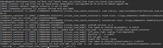

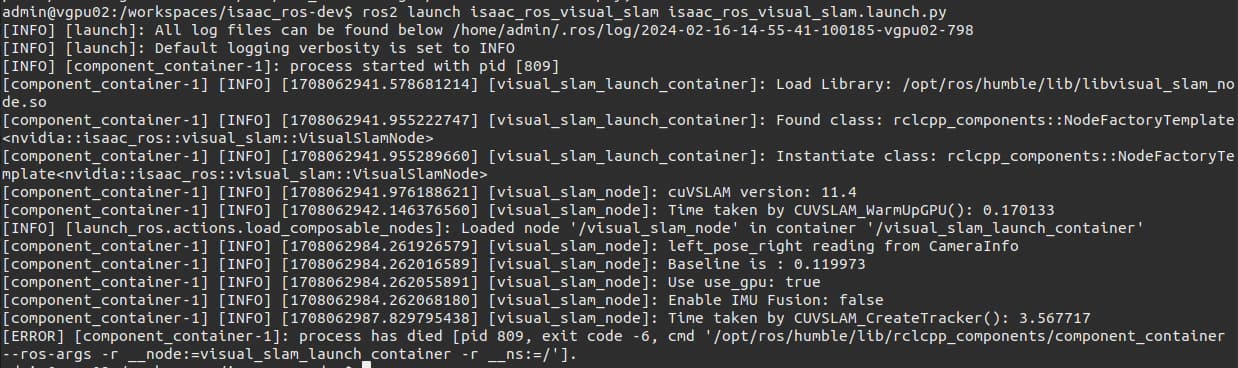

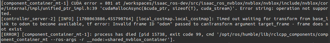

Error Detail is like below;
Visual_slam:
Nvblox:

Are there any one success to run visual_slam & nvblox on Ubuntu 20.04(Vmware Horizon) such as GPU(L40S)?
I would appreciate if you tell us how to solve this problem.

Hi @mat-h
You are working on an environment not tested; I suggest checking our page with the system requirements.
Overall, looking at your screenshots the driver installed on your virtual machine uses a not supported CUDA configuration, the screenshot report:
‘cudaMallocErrorAsync(&cuda_ptr, sizeof(T), cuda_stream)’. string: operation not supported
