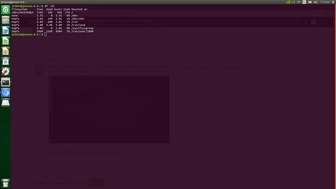

It might be related with the free space. What do you get when you type “df -lh” ?

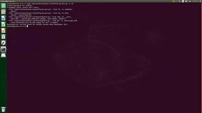

@ozguryildiz @ozguryildiz Thanks I have try to access the pwm pins on jetson nano B01 based on the link as you mentioned above along with that I tried a configuring jetson nano 40 pin expansion header and the link is here(https://docs.nvidia.com/jetson/l4t/index.html#page/Tegra%20Linux%20Driver%20Package%20Development%20Guide/hw_setup_jetson_io.html)
It throwed an error as attached screenshot
I have also attached a screenshot of free space as you mentioned above

The same issue discussed here. Actually it was known issue for JetPack 4.3.
They solved with this:
Otherwise you can update your JetPack version.
Regards
@mehmetdeniz Thanks for your reply I solved the error.

Maybe you have not enough space to boot up your GUI. If you can log in from debug console can you check the free storage on your Jetson with “df -h” command?
@mehmetdeniz I already checked it the free space using the command df -h and attached the screenshot above
