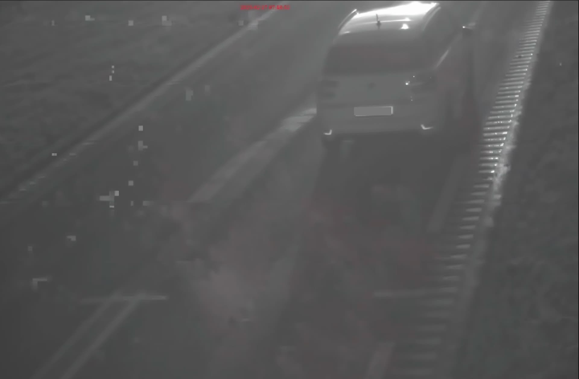

Description of Issue:
I’m encountering an issue while using two YOLOv11 models (one for vehicle detection and another for license plate recognition) within DeepStream 7.1. Both models perform well when tested outside of DeepStream (using the same ONNX files), but only the vehicle detection model displays bounding boxes correctly within the application. The license plate model fails to show any detections despite similar configurations.

Yes, I simplified the setup, because it wasn’t detecting the license plates as a secondary GIE either. It has just primary GIE now for testing.
After training it was exported as:
yolo export model=trained_models/best.pt format=onnx imgsz=640,640
Its shape:
File name: trained_models/best.onnx
Model: main_graph
Inputs:
Input 0: images, Type: 1, Shape: [dim_value: 1
, dim_value: 3
, dim_value: 640
, dim_value: 640
Outputs:
Output 0: output0, Type: 1, Shape: [dim_value: 1
, dim_value: 5
, dim_value: 8400
Tested and working when ran with:
yolo predict model=trained_models/best.onnx source=video.mp4 imgsz=640 task=detect save=True project=predict name=video_with_boxes
But getting no bounding boxes when run in DeepStream:
Just to detect the license plate.
