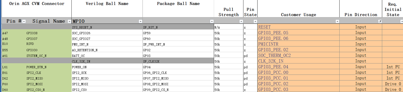

Hi NV Support Team
Can you please check if this is typo for Pin F60, D60
The pin direcction are input but the initial state are drive 0.
I dont think input signal can output 0 or 1 .

That’s initial pin status during power on. Custom usage can be set after that.
Yes, I know
But I think your pinmux template default setting for Pin F60, D60 is incorrect.
Because the input & drive0 in default pinmux tools for F60
My query is that: why input signal can drive 0 in pinmux.
Yes, it is a typo in new release. It should be “Int PU”. Will update it, thanks.
