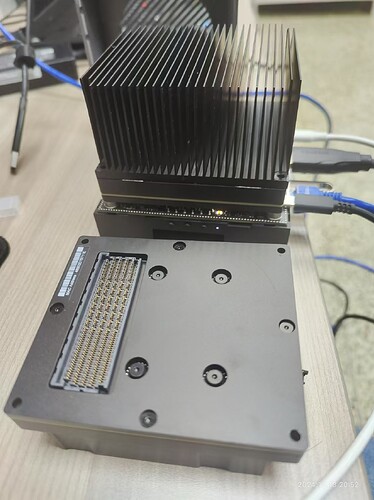

Do you have other Jetson Orin on your side that can check if all the Jetsons there would have same issue with that screen?
I’m very sorry, I only have one baseboard, but I have two GPU core boards. Both boards cannot light up the screen.
Like this
Will the xorg log get anything new if you use a DP-HDMI adapter + HDMI monitor on your board?
But the other GPU core board was refreshed through sdkmanager. I can try it again with flash.sh.
The log file remains unchanged. Use the image connection method.
