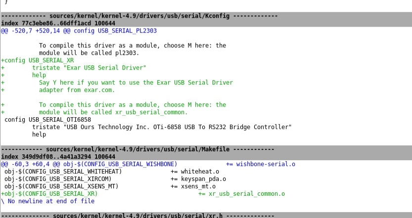

I use Jetson L4t package to build image , including kernel compile.
Add above EXAR usb driver into kernel source code(KCONFIG , Makefile) ,
then recompile and flash to NX.
Kernel will generate ttyXRUSB0 device if you plug in EXAR USB serial devices.

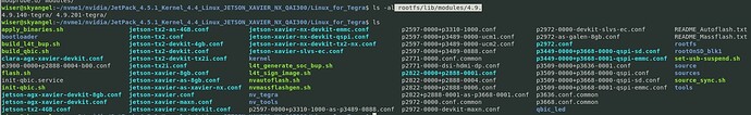

I rebuild L4T 32.5.1 (jetpack 4.5.1) with older 4.9-140 kernel source from L4T 32.4.3(jetpack 4.4 ).
build_l4t.sh (2.5 KB)
and l4t file structure
I delete 4.9-201 in rootfs/lib/modules/ , use 4.9-140.
Then flash to NX
When it boot up , System logo is the newer 32.5.1 one.
nv_tegra_release shows 5.1 as well.
Kernel is the replaced 4.9-140.
But it has some issues like :
nvpmodel power mode switch will failed
apt repo and network also work not properly.
Most important , exar driver is also not worked, as above reply described.
