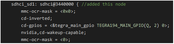

아래는 Jetpack4.6.x버전에서 sdcard 인식을 시키기 위해 질문했던 글입니다.
Jetpack5.0.2에서는 아래의 tegra194-p3668-common.dtsi 파일에 sdhci 노드를 추가했었습니다.
/Linux_for_Tegra/source/public/hardware/nvidia/platform/t19x/jakku/kernel-dts/common/tegra194-p3668-common.dtsi
Jetpack 5.0.2에서는 어느 파일을 수정해야하나요?
고맙습니다.

The method should be same but we didn’t validate. NVIDIA does not have any NX custom board which has sdmmc3 enabled with sdcard.
You can share your dmesg, schematic and dts file here to check. My point is sharing these information should be the basic but not asking me which file to modify. You have been here for almost 2 years. So I think sharing these information should be a common sense to you.
