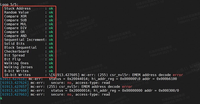

[JetPack 5.2.1] mc-err: (255) csr_nvl5r: EMEM address decode error
Test environment: jetpack 5.2.1
Test module: jetpack-Orin-AGX 64G
Test command: ./memtester 30G 5
When we used the “memtester” tool to conduct memory testing, an error occurred suddenly on the fifth test. The error message was EMEM address decode error. The following error information and test log are shown below.
Jul  9 16:13:17 ubuntu kernel: [17988.711552] NVRM nvAssertFailedNoLog: Assertion failed: minRequiredIsoBandwidthKBPS <= clientBwValues[DISPLAY_ICC_BW_CLIENT_EXT].minRequiredIsoBandwidthKBPS @ kern_disp_0402.c:111
Jul  9 16:13:55 ubuntu kernel: [18026.185693] NVRM nvAssertFailedNoLog: Assertion failed: minRequiredIsoBandwidthKBPS <= clientBwValues[DISPLAY_ICC_BW_CLIENT_EXT].minRequiredIsoBandwidthKBPS @ kern_disp_0402.c:111
Jul  9 16:14:00 ubuntu kernel: [18031.447784] NVRM nvAssertFailedNoLog: Assertion failed: minRequiredIsoBandwidthKBPS <= clientBwValues[DISPLAY_ICC_BW_CLIENT_EXT].minRequiredIsoBandwidthKBPS @ kern_disp_0402.c:111

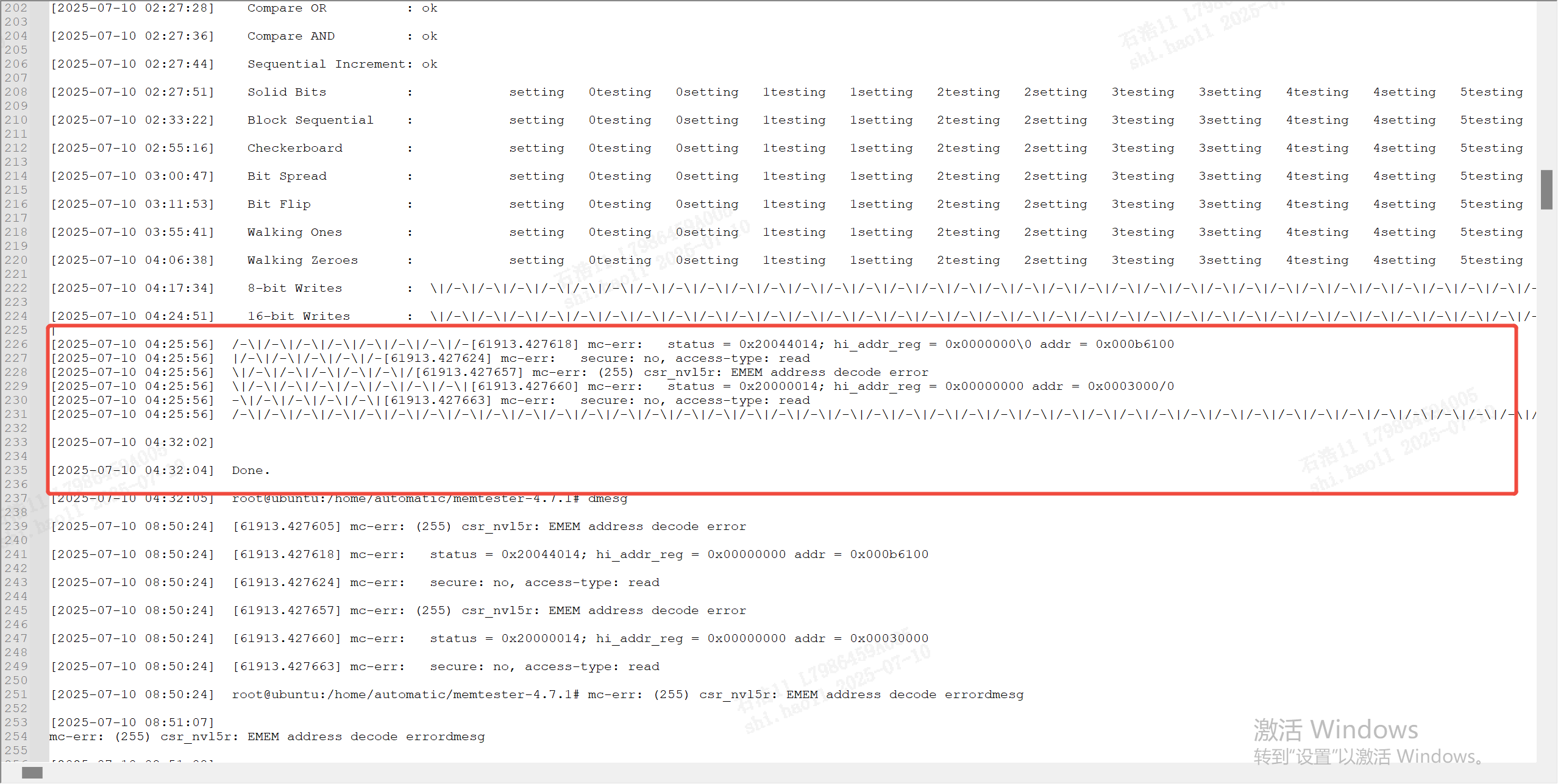

Jul 10 04:25:22 ubuntu kernel: [61913.427605] mc-err: (255) csr_nvl5r: EMEM address decode error
Jul 10 04:25:22 ubuntu kernel: [61913.427618] mc-err:   status = 0x20044014; hi_addr_reg = 0x00000000 addr = 0x000b6100
Jul 10 04:25:22 ubuntu kernel: [61913.427624] mc-err:   secure: no, access-type: read
Jul 10 04:25:22 ubuntu kernel: [61913.427657] mc-err: (255) csr_nvl5r: EMEM address decode error
Jul 10 04:25:22 ubuntu kernel: [61913.427660] mc-err:   status = 0x20000014; hi_addr_reg = 0x00000000 addr = 0x00030000
Jul 10 04:25:22 ubuntu kernel: [61913.427663] mc-err:   secure: no, access-type: read
The test screenshot is as follows
We would like to know the reason for this error?
The kernel log is shown in the attachment.
