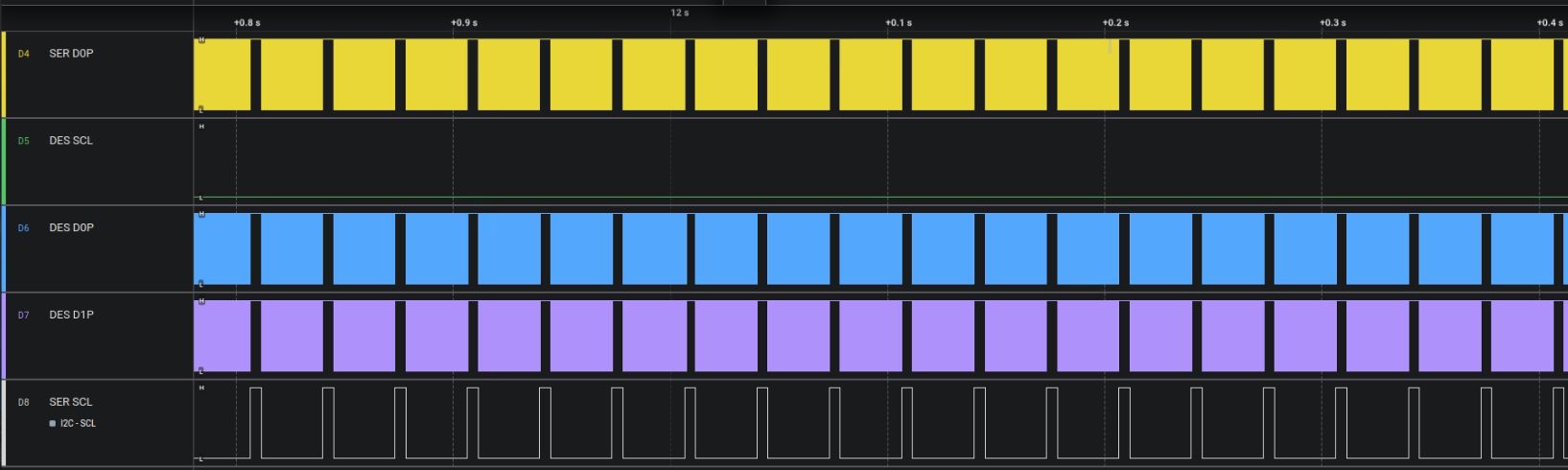

I am not able to capture the sensor image using the MAX96717R and MAX96724R serializer and deserializer boards in a GMSL setup interfacing with the AP1302 ISP/AR0234 sensor.
Hardware:
  • Jetson AGX Orin, JetPack 6.0 / L4T 36.3
  • MAX96724R deserializer → serial_d / port-index 3
  • AP1302 ISP, 2-lane DPHY tunnel mode, YUV422
Symptom:
v4l2-ctl capture times out with:
tegra-camrtc-capture-vi: uncorr_err: request timed out after 2500ms
Logic analyzer shows:
  • DES D0P (DA0): active data bursts ✅
  • DES D1P (DA1): active data bursts ✅
  • DES CKAP (clock lane): completely flat ❌
SerDes confirmed working:
  • VID_LOCK = 0x62 ✅
  • 2(1x4) D-PHY mode, 900 Mbps, discontinuous clock
DTS:
  • tegra_sinterface = “serial_d”, port-index = 3
  • bus-width = 2, data-lanes = <0 1>
  • link-frequencies = 1000000000
The GMSL2 tunnel is working end to end but the Jetson CSI PHY sees no clock. Is there a known issue with MIPI clock output on serial_d with JetPack 6.0, or any additional register/DTS settings needed to enable the clock lane?
I am attaching the below files:
  1. Snapshot of the clk and data waveforms for the serializer and deserializer
  2. dmesg log file
  3. trace log file
camera_dmesg_full.log (66.3 KB)
camera_trace.log (8.7 KB)
I would appreciate any pointers to resolve this problem. Thanks!
The MIPI clock is control by the GMSL, suppose it could be GMSL config or HW problem.
