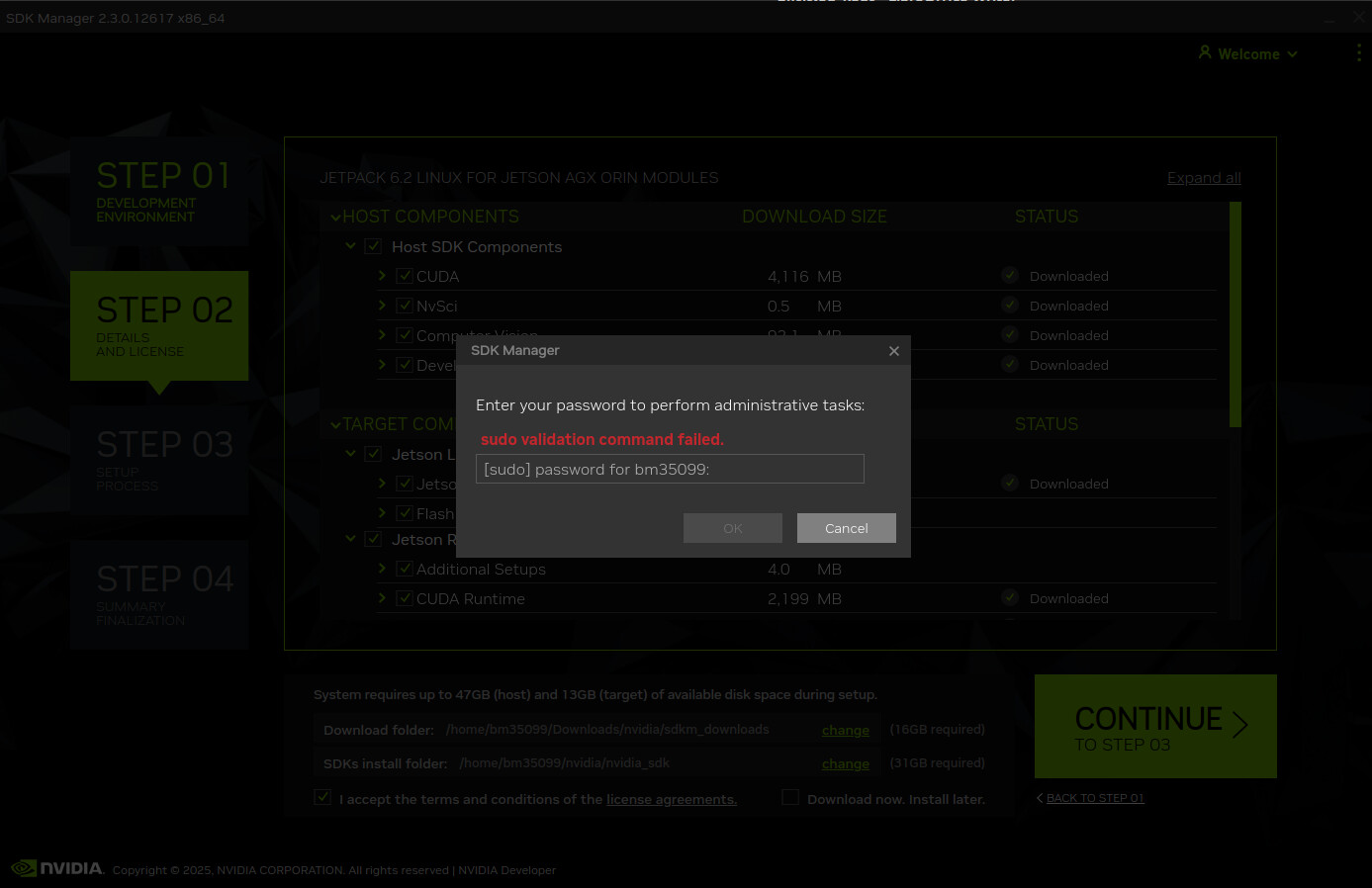

OK so I am no longer using a VM or docker. I have a host machine (ubuntu 20.04) and whenever i try to run the sdk manager (either gui or cli) when it comes to the installation part of the process I get asked to enter my sudo password into the app but it does not take my password. When I use sudo to start the sdkmanager it tells me that installation of jetpack is not available as superuser. So I get stuck on this part of installation I am not too sure what to do here. Has anyone else encountered this issue?

im getting hit with this even after running through the steps provided
To be clear; that box wants your local computer logon password. Which may be different from your developer.nvidia.com password unless you made them the same.
I understand what the box is asking, it wont accept my sudo credentials for my computer and im asking is there a way to bypass this or why is it only inside the sdkmanager interface that it wont accept my sudo credentials

It didnt work, no matter what I do i end being prompted for sudo on the installation step and getting hit with “Sudo Validation Command Failed”
