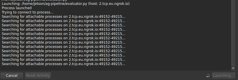

thanks for your answer. I’ve installed the NVIDIA Nsight Compute from your link and followed the documentation to connect it to the Jetson and launch the target application on it. However, after the process is successfully launched, it seems that the Nsight Compute get stuck on searching for attachable processes. The output of the console looks like this:
Have I misunderstood something? Should I use a different profiling tool or change something in the way of launching the target process?
You will need to use the Nsight Compute integrated in the JetPack.
Please install the CUDA package for host and find it in /opt/nvidia/nsight-compute/2019.5.0
