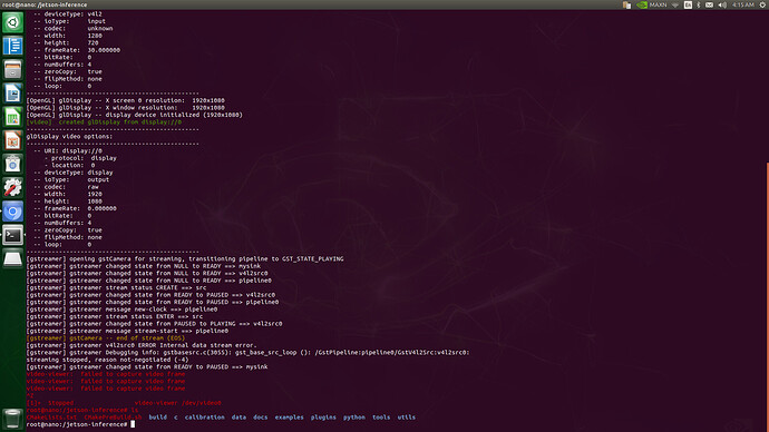

Is anyone experiencing camera issues preventing them from running root@nano:/jetson-inference# video-viewer /dev/video0
Im getting the following video-viewer: failed to capture video frame
even though i do have a recognized cam connected dev/video0 and utilizing Dustys github docker install

Hey, Dusty thanks for your help, seems to be a gstreamer issue. see photos
 ![Screenshot from 2020-12-01 04-15-19](https://global.discourse-cdn.com/nvidia/original/3X/9/2/929c9d1a3739533a638c5812805de95fa4d5ef5f.jpeg)

Regarding what camera I’m using I believe I’m using a ras cam v2 but not 100% certain bc the cam is inside of an enclosure along with the nano.
 ![Screenshot from 2020-12-01 04-15-39](https://global.discourse-cdn.com/nvidia/original/3X/c/3/c301bc1fdf6971d927392d06c68cee10697e0ef8.jpeg)

> [@hossboss7](#):
OK gotcha - the Raspberry Pi Camera Module v2 is a MIPI CSI camera, so please try launching video-viewer like this:
```bash
$ video-viewer csi://0
If that doesn’t work, please post the output of this `v4l2-ctl` command:
```bash
$ sudo apt-get install v4l-utils
$ v4l2-ctl --device=/dev/video0 --list-formats-ext

Dusty thank you very much. Would there be a reason # detectnet /dev/video0 wouldn’t run or #detectnet csi://0 ? Also is there a way to flip the camera in 90 degree angles with the jetson utils? I know previously this was only possible with 180 degree angles or I needed to use opencv, is this still the case?

> [@hossboss7](#):
The Raspberry Pi Camera Module v2 should be used as csi://0, because through V4L2 that camera only supports raw 10-bit bayer mode, which neither I or GStreamer have the code to debayer 10-bit. Regardless, it is more efficient to use it through the csi://0 interface (which uses libargus) and the picture quality should be better as it includes ISP processing.
> [@hossboss7](#):
You should be able to use the `--input-flip=clockwise` (or `--input-flip=counterclockwise`) and run it as:
```bash
$ video-viewer --input-flip=clockwise csi://0
For more options to `--input-flip` argument, run the program with `--help` or see here:
[https://github.com/dusty-nv/jetson-inference/blob/master/docs/aux-streaming.md#command-line-arguments](https://github.com/dusty-nv/jetson-inference/blob/master/docs/aux-streaming.md#command-line-arguments)

all set thank you sir. up and running!
