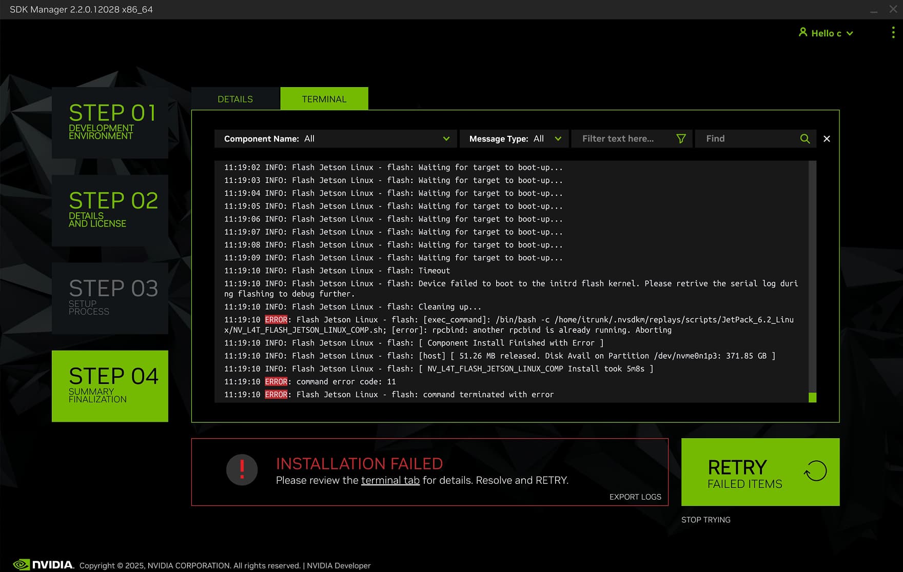

I downloaded Jetson firmware on Ubuntu 22.04 and encountered the error shown in the picture,How can I solve it?
Please press EXPORT LOGS and attach a zip file to us to review.
Also some questions to confrim
  • Is your ubuntu a physical or a virtual machine(e.g. VMware VirtualBox)?
  • Is your device a dev kit or a custom board.
Okay, I’ll send the log later,thanks
1- ubuntu a physical
2- custom board.
this is my download logs,plese check
ERR LOG.zip (1.8 KB)
Is your custom board you design or bought from other company?
Because the sdk manager only support dev kit, you need to reach out the vendor you bought for the custom bsp.
我是照着官方的板子进行设计的,和官方板子一模一样,请告诉我如何解决,谢谢
To debug with custom board, please attach a serial console log.
Please refer below link to record a serial console log
