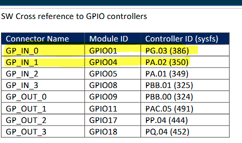

With this mode set you provide a string that corresponds to the GPIO you’re trying to configure as output or input, but what would that look like? If I run: sudo cat /sys/kernel/debug/gpio
Would either of the highlighted options work (in the scenario they’re configured as a regular GPIO in the pinmux). Would I be able to define the pin HIGH/LOW by using either “gpio-487” or “PAC.01” as a parameter.

Thanks for the clarification. Just to follow up on my original question.
Using the TEGRA_SOC method, how should I define parameter that is passed into the GPIO.setup() method?
For example when enabled using GPIO.board() mode you can do the following
GPIO.setup(10, GPIO.in)
This would set pin number 10 as an input. But how would you do that for the other method:
GPIO.setup("gpio485", GPIO.in)
Where can I find my corresponding pins string name?

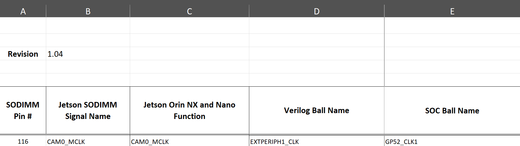

thanks for that example. One last question, in your answer you provide this entry:
(92, 'PP.00', "tegra234-gpio", 41, 28, 'CAM0_MCLK', 'GP52_CLK1', None, None),
What do the integers 92, 41, 28 represent? Additionally, How do I get the signal name i.e. ‘CAM0_MCLK’
and ‘GP52_CLK1’, I am assuming those are capabilities of the PP.00 pin, depending on the pinmux, but where can I grab the corresponding signal name?
41 and 28 are just 2 used number in the table.
You can find CAM0_MCLK in Column B(Jetson SODIMM Signal Name) and GP52_CLK1 in Column E(SOC Ball Name) of pinmux spreadsheet.
