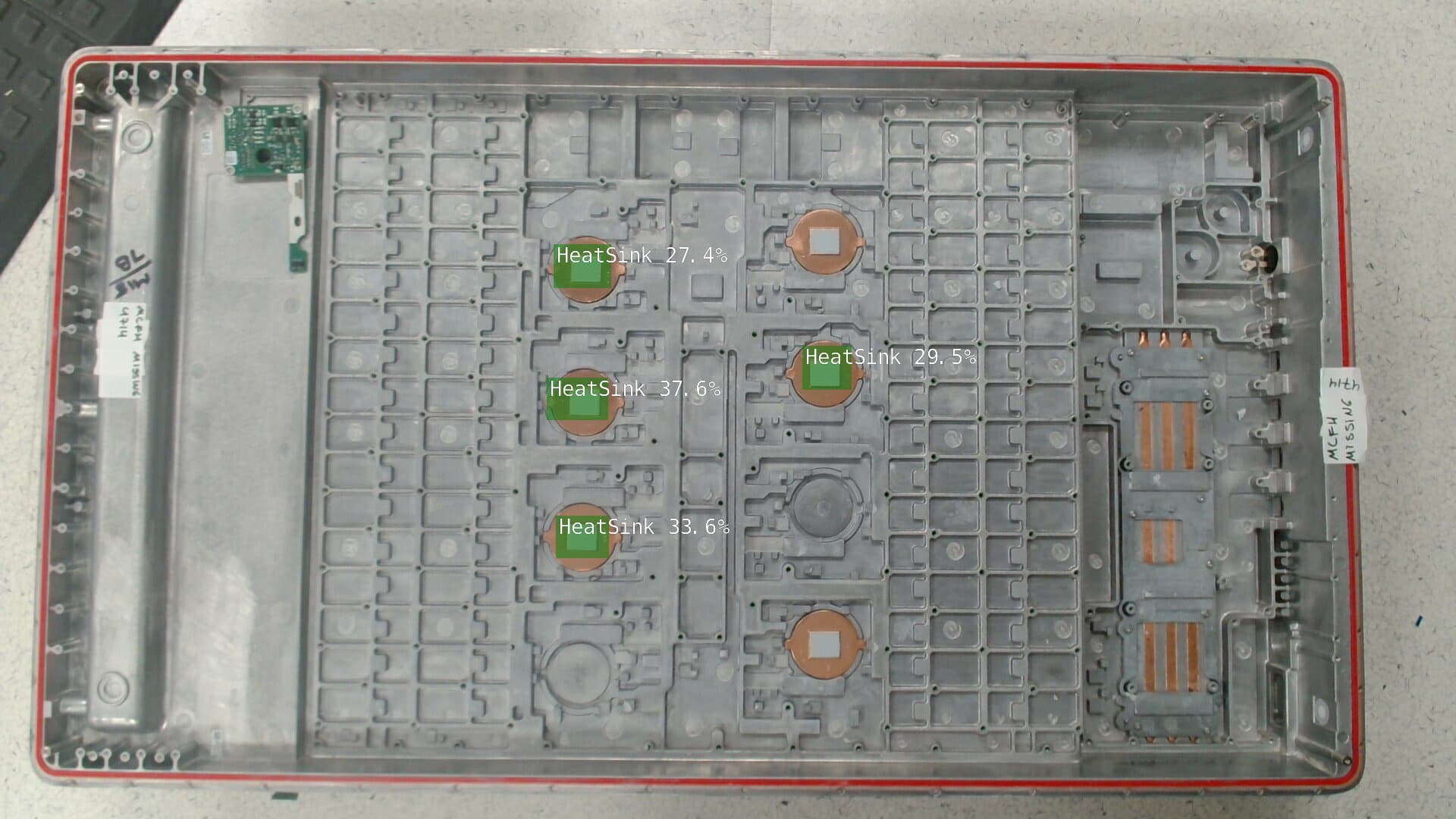

What is the reason that I do not detect the object at a distance greater than 30 centimeters, when I am using more than 300 images per class (Paste and NO_Paste).
This image is 20 cm from the objects:
and this is 35 centimeters away, from this distance it does not detect any object:
Are there some images with objects at a distance greater than 30 centimeters?
Please note that jetson-inference apply resizing before feeding the image to the DNN.
For example, SSD-Mobilenet input is 300x300 so it might not be good for the small objects.
There is discussion to increase the network input size for small objects:
Yes, I have images larger than 30 centimeters that I used in training, I already changed the resolution to create the ssd-mobilente.onnx ($ python3 onnex_export.py --resolution=512 --model-dir=models/Coin/), and changed the threshold for the detectnet, these are my results, with the same image, which I actually used for training.
What modifications can I make to improve my model? I have already used more than 300 images for training, changed the resolution and performed tests with the threshold.

Do you want to detect the circle or just the white square?
Could you also share some training images and the corresponding label with us?
I want to detect the white square, I have two classes, when trying to do the training I have the following error.
The error comes from a custom script called Opencv_LabelSiemens.py.
It requires a library called tesseract.
Have you installed it in your environment?
If not, please try to install it and try it again.
