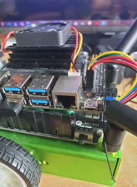

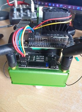

Unfortunately now the robot has stopped powering on, I’ve been suggested by waveshare to use this command to find out if there’s something wrong with the i2c address:
i2cdetect -y -r 1
Unfortunately, I don’t know why robot suddenly stopped displaying anything on screen:
117609133_217428736361001_6518502572841521758_n
117772733_348677729489187_367291946970571371_n
Do you have an idea why I’m having problems getting things to display via hdmi? It was working just a few days ago only to stop working after charging up my batteries
Hi Staffsbane,
Apologies for the delayed response. I’m sorry to hear that the JetBot is behaving differently after charging the batteries.
I would first try to address if this is a hardware issue, and if so where the issue lies. Have you tried booting the Jetson Nano without the JetBot attached?
I would try this with power directly connected to the Nano, and all wires the the robot removed. Please use caution, I believe the power adapter that Waveshare ships for the Robot base is 12V, while the Jetson Nano power barrel is 5V.
Please let me know if you run into any questions testing this. I look forward to hearing back with your results.
