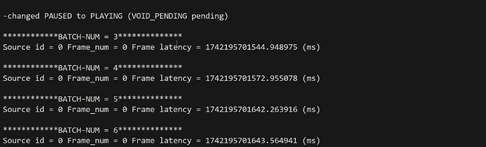

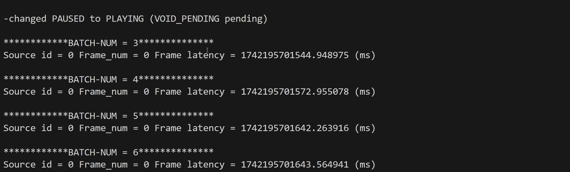

GST_DEBUG=4 NVDS_ENABLE_LATENCY_MEASUREMENT=1 NVDS_ENABLE_LATENCY_MEASUREMENT=1 ./deepstream-test1-app rtmp://10.0.0.50:1937/safevideolive/pfs/123
When I run the above latency test command, I get the following results, thanks for your guidance.
I think there is something wrong with the code you ported, the latency seems to be too high.
I just replaced osd_sink_pad_buffer_probe with latency_measurement_buf_prob. Also, I set num_sources to a constant 1. This also makes me very confused.
This measurement approach determines the input timestamp based on the name of the nvv4l2decoder element, and you are using test1, which may cause some problems.
Try the following code snippet.
