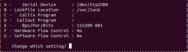

As for the garbled message, what is the command you are using to enable serial log?
I have preconfig username and password by using sdkmanager
sudo minicom

sudo minicom
Please set the baud rate to 115200 explicitly.

The baud rate always 115200 for our usage
