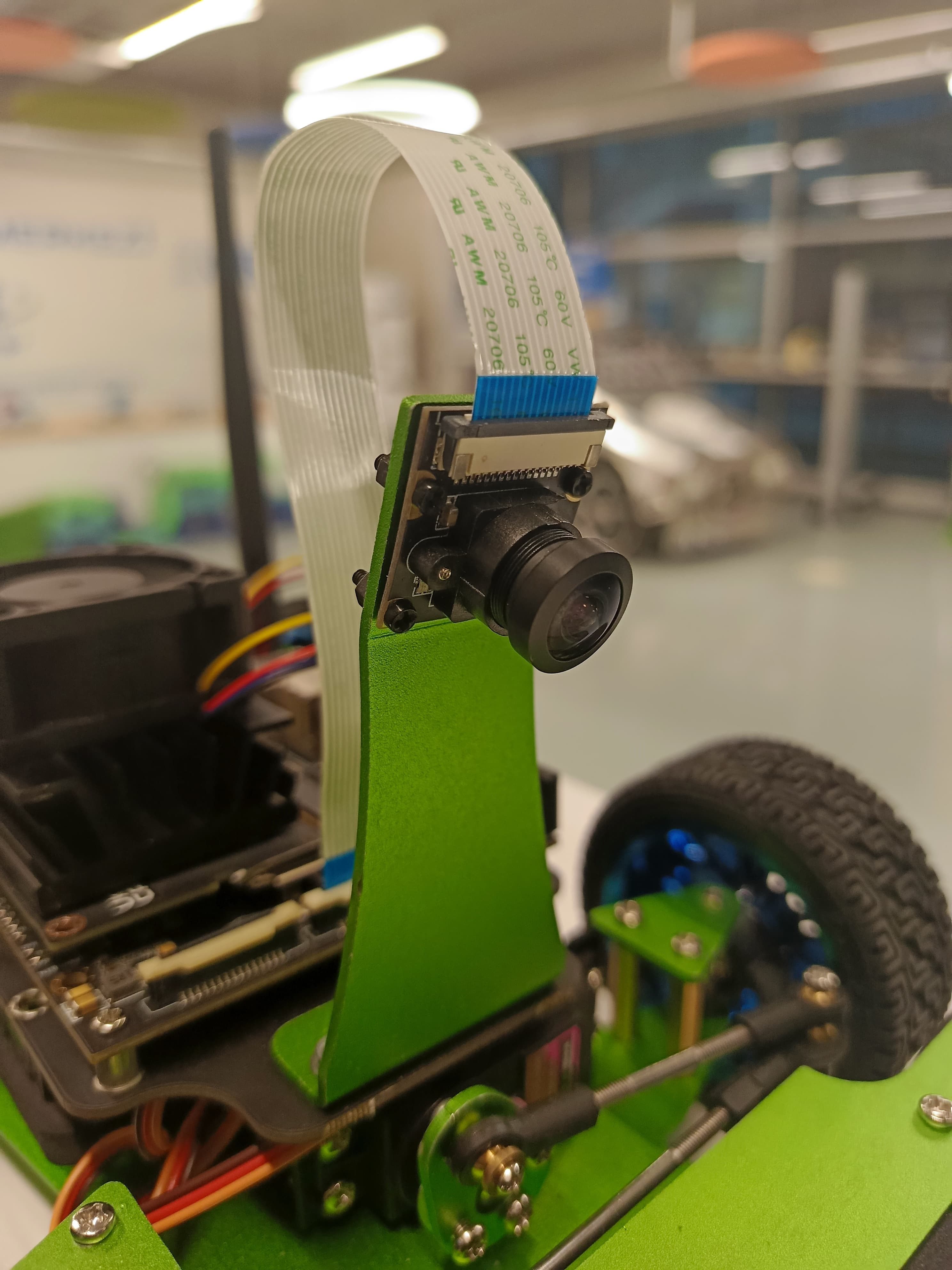

So I have a JetRacer AI kit (with Jetson Nano Dev Kit 4GB), and it has JetPack 4.5.1. I am trying to open the camera, but every time I do, the Jetson Nano crashes and reboots itself. I thought it might be a power issue, so I switched to a 5V 4A barrel jack power supply instead of using pins, but the problem persists.

I don’t have a USB camera available for testing, but I do have Raspberry Pi Camera Module 2 and 3. If it would help with debugging, I can try using one of those.
Additionally, I should mention that my system is booting from USB storage instead of an SD card. Could this be a factor in the issue?

Just out of curiosity, what camera module are you using?
