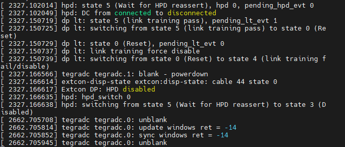

My Jetson Nano was working fine yesterday, I have shutdown it. Today when I start it and is not giving display in HDMI or DP port. I have tested it using serial port where it is giving display and running all commands. I ma here to ask if there is any way to fix this issue and restore it’s display on HDMI and DP using serial command ?

You need a serial console cable to view uart log.

You have to use serial console cable connecting to the TXD/RXD/GND pins of the board. Micro USB port is used for flashing the board, not for serial console log.

TXD/RXD/GND should be at the opposite side of your power/HDMI/DP port of the devkit.

Please help to provide the uart log after you setup serial console and also dmesg for further check.
