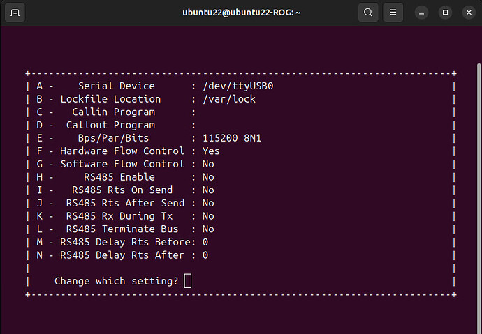

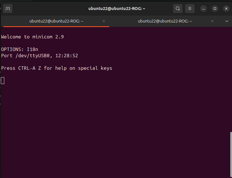

Thanks for the response. I followed all the steps mentioned in the video. I’m using a Jetson Nano B01 connected via a TTL converter, and I’ve also set the correct baud rate. However, after running the command ‘sudo minicom’ and then powering on the Jetson Nano, I’m not seeing any kernel logs in the minicom terminal. Also I checked with multimeter, I’m getting 3.3V in the jetson.

I have connected TTL to RXD, TXD and GND of Jetson J50 header

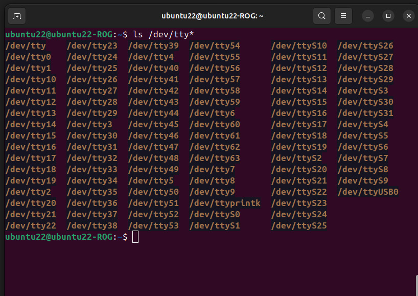

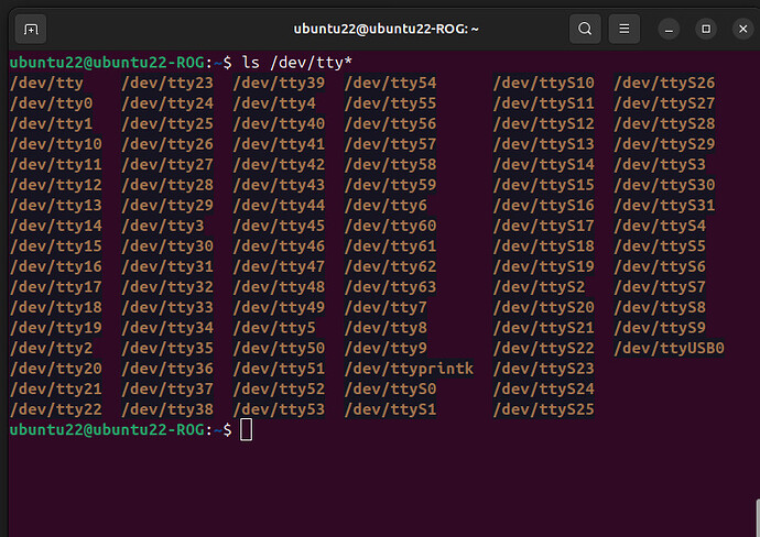

Do ls /dev/ttyACM* show other Serial Device.
Yes, I did this. But I can’t able to find any serial device.
These are the only serial device it shows
It’s right to connect with /dev/ttyUSB0to get the serial log.
Could you make the device in recovery mode and flash again?
