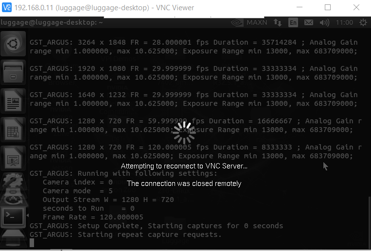

Hello everyone! Recently I ran into the problem that my jetson nano got rebooted after execute video-viewer csi://0 or gst-launch-1.0 nvarguscamerasrc sensor-id=1 ! ‘video/x-raw(memory:NVMM),format=NV12’ ! nvvidconv ! xvimagesink sync=false command. (Yesterday everything is normal ). What should I do?
This is screenshot from jetson nano
Try ssh instead of VNC. Or connect HDMI display to check.

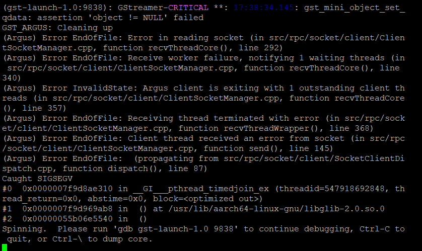

I just bought a new cable and I ran the gst-launch command it responded with a new message
Could you reboot and try nvgstcapture-1.0 also what’s the gst command?
this gst-launch-1.0 nvarguscamerasrc sensor-id=1 ! ‘video/x-raw(memory:NVMM),format=NV12’ ! nvvidconv ! xvimagesink sync=false

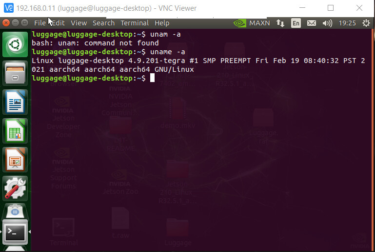

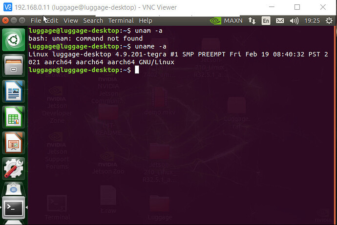

What’s the BSP version? Could you try latest release.
Dear ShaneCCC
is this latest release ?

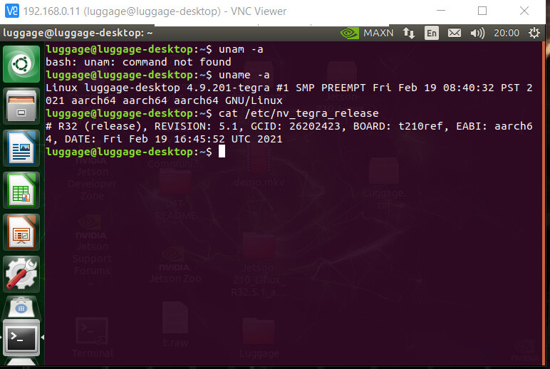

Check the version by cat /etc/nv_tegra_release
Dear ShaneCCC ! Here it is

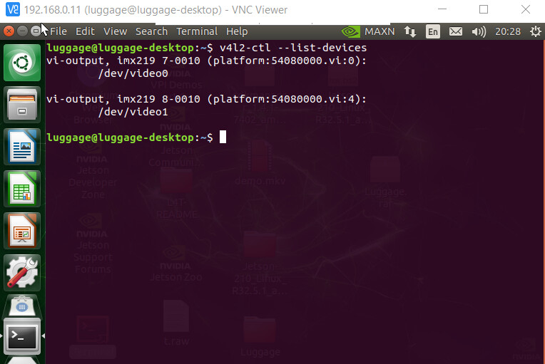

Could you confirm if v4l2-ctl working for both video0 and video1.
Dear ShaneCCC Here it is!
(* notes I bought 2 camera sensor so I tested for 2 slot at the same time)
I mean
v4l2-ctl --stream-mmap --stream-count=100 --set-ctrl bypass_mode=0 -d /dev/videoX
