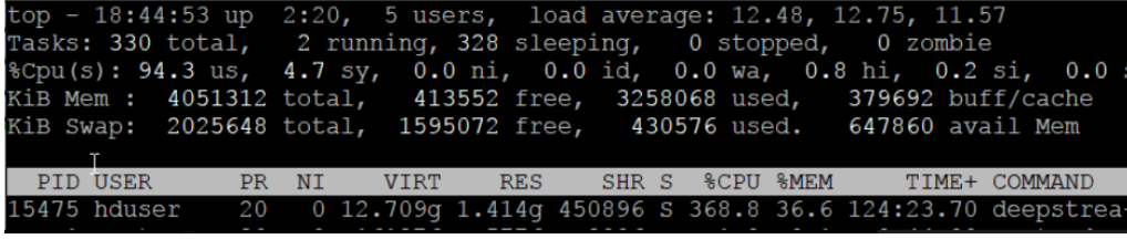

The top utility confirms that it is deepstream that is using all of the CPU:
https://i.imgur.com/EZwQqII.png
