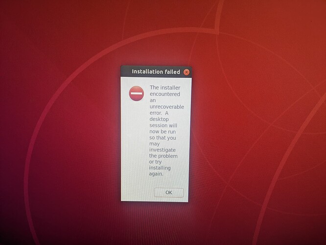

I recently bought a Jetson Nano 2GB. I am trying to bring up the board for the first time and have followed the instructions as per Getting Started with Jetson Nano 2GB Developer Kit | NVIDIA Developer. When I put the SD card into Jetson and connect it to the Monitor, I am being asked for ID and password. Any help? I tried multiple times with multiple SD cards, starting fresh. I am getting stuck with the same thing.
Which version of sdcard image are you using here?
Also, what is the tool you use to install the sdcard image?
Could you also download a fresh image from the website again instead of using the same image to flash all the sdcards?
Hi, thanks for the reply. The cards i am using are HC I and XC I. 32GB and 128GB respectively. Tool for installing the image on sdcard is balena etcher.
I just tried downloading fresh image again. Same issue again. While booting up the first time, this error comes up. (please see the picture)

SDKM does not read the software that pre-installed on the board. It will format it no matter what was pre-installed on the board.
If you cannot make it flash the board, it is probably some operation error or compatible issue. For example, if your host machine is a VM, then it may not able to detect the jetson. Also, if the board is not in recovery mode, host cannot flash it.
And just some explanations about this issue.
First, the jetson nano module has a QSPI-NOR flash. This device has bunches of bootloader software. The reason we can insert a sdcard image and let it boot is due to this software. This software was pre-flashed by factory.
The problem here is: It seems rel-32.7.1/jetpack4.6.1 is not compatible with specific version of bootloader.
The methods to workaround this:
method 1: directly flash sdkmanager with jetpack4.6.1. Unlike sdcard image, sdkm will update the bootloader in QSPI, which means this incompatible problem will no longer exist.
method 2: put a sdcard image >= 4.5.1 jetpack version(except 4.6.1). Because new release like 4.5.1/4.6 sdcard image is able to update the QSPI bootloader after it boots up and takes about few mins to update the bootloader software. After this, you can even use jetpack4.6.1 image again and it shall be fine this time.
And the reason why we need your help is because we cannot really know the exact version that hit this issue. If you are not able to share serial log, please at least share me the syslog (/var/log/syslog) right after you try method 2.
The bootlaoder update log will be saved in syslog and we can know what is going on.
