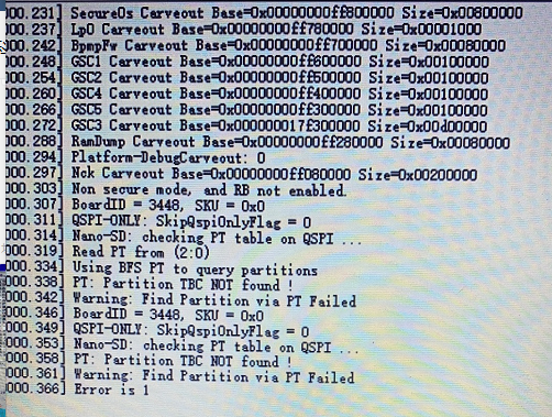

How to solve this problem after jetson nano b01 is turned on?
1624768267(1)
Flash the board with sdkmanager.
Hello, thank you for your reply. The problem has been solved, but I want to understand why this problem occurs to prevent this problem from occurring next time.
After you try a fresh sdcard image, boot up and wait for about 10 mins. And this shall prevent such error.
Next software release will also enhance this.
