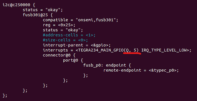

I’m working on our customized board, which is based on the Orin Nano development kit, but with an additional 2nd Type-C port added.
The 2nd Type-C port combines USB3-0 and USB2-1. We modified the device tree and got it working, but there’s a strange minor bug that I believe is related to the USB detect pin.

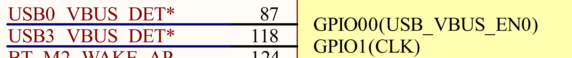

Our second Type-C detect pin is connected to pin 118, which is GPIO(Q, 5). After configuring GPIO(Q, 5) correctly in the device tree, we encountered an issue: when unplug the 2nd Type C, it causes the 1st Type C disconnected but only the USB2 part of it disconnected. However, if we unplug the 1st Type C, it will not affect the 2nd Type C.
The strange thing is that when we assign the detect pin to a random incorrect pin for the 2nd Type C—like GPIO(Z, 2)—the problem disappears.
We also tried assigning an incorrect pin to the 1st Type-C port, which caused it to completely malfunction.
So why does the incorrect setting make it work fine, while the correct one seems to cause a bug???

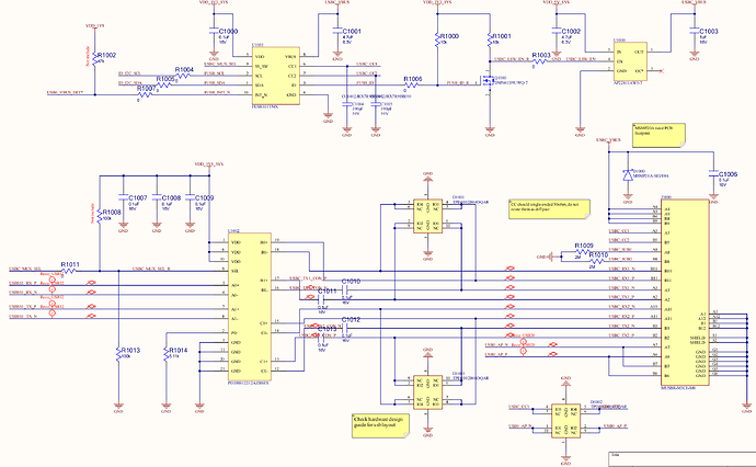

Could you share the schematic of the whole USB part?
And also the dmesg with error log?
Hi Wayne,
Thanks for your response. Below are the schematics for the entire USB section.
To summarize:
  • USB Type-C 1 is an exact replica of the Nano Dev Kit’s recovery USB Type-C, including the same hardware and pin assignments.
  • USB Type-C 2, which we added, uses the same hardware design as the recovery port but with a different pin configuration.
    Pin assignments:

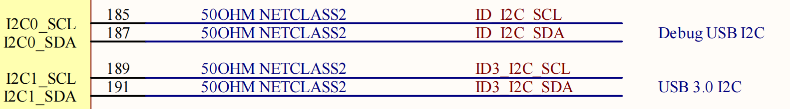

  • USB Type-C 1: USB3-1 + USB2-0 + I2C_0 (pins 185 & 187) + USB Detect (pin 87)
  • USB Type-C 2: USB3-0 + USB2-1 + I2C_1 (pins 189 & 191) + USB Detect (pin 118)
