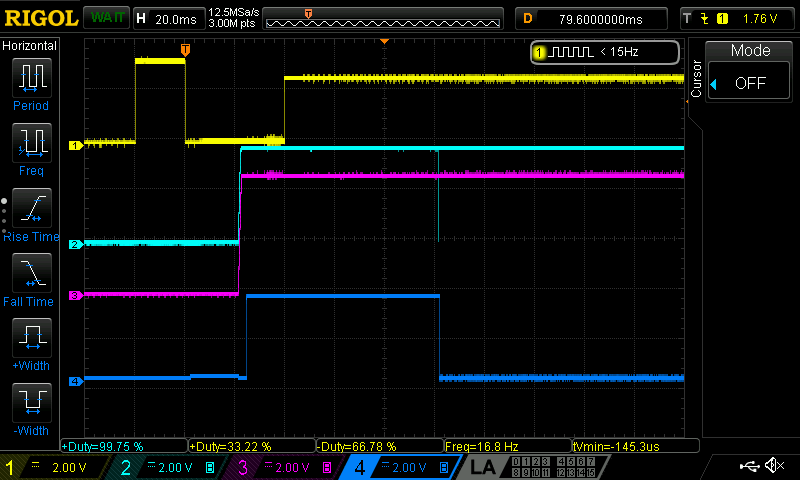

We did take some scope captures of the timing diagram to help debug. Does the timing diagram look correct? For some reason, we are seeing a random high; maybe the module is doing it for the pink channel, which is the MODULE_POWER_ON signal. This blip also coincides with the CARRIER_POWER_ON signal going high, then randomly going back low, and then our embedded controller drives the signal again (that is the blue signal).
Yellow - Power_BTN_N
Cyan - VDDIN_PWR_BAD_N
Pink - MODULE_POWER_ON
Blue - CARRIER_POWER_ON

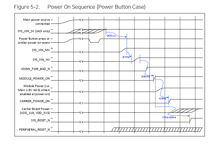

MODULE_POWER_ON and CARRIER_POWER_ON are not expected to go high-low-high like your capture.
MODULE_POWER_ON is an input to Jetson AGX Orin so is your embedded controller driving it high, then low, then high? This is not expected.
CARRIER_POWER_ON is an output from Jetson AGX Orin, not an input or bidirectional. So the EC should not drive it.
If your probe can handle the 12V level, can you move the CARRIER_POWER_ON to your VDD_IN and re-capture, triggering on the same PWR_BTN falling edge? Also please zoom out further to check for other behavior on the MODULE_POWER_ON.
Your screen capture of Figure 5-2 from the Jetson AGX Orin Design Guide is an older one. Please refer to the latest, which is v1.8 released about a month ago.
