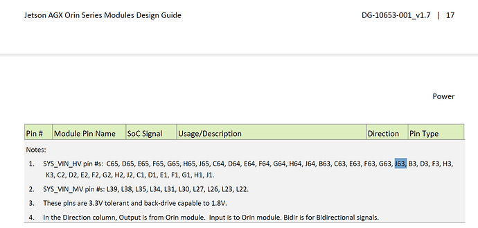

To what should we connect this pin? (Jetson orin agx industrial j63 pin)
Should it be voltage-if yes, which one? Or ground? Something else?
Regards
J63 is SYS_VIN_HV.
Please refer to Jetson AGX Orin Series Design Guide (including AGX Orin Industrial) and the pin list is attached to this design guide Log in | NVIDIA Developer
