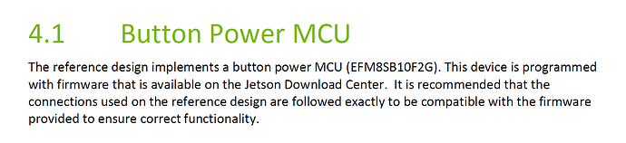

A custom carrier card is developed for jetson orin nano and MCU is flashed with the EFM8SB1OF2G.HEX file downloaded form jetson download centre (P3737_P2822_P3509_POWER?_BUTTON_FIRMWARE_V011). We observed the VIM_POWER_ON and POWER_EN signals are high. Voltage going to the GPU is 5.3V and GPU set the sys_rst_n pin to high. This signal is given to level shifter but the output is always low. Not able to find the issue.
Please check your carrier board schematics to ensure
Refer to Jextson Orin NX Series and Orn Nano Series Design Guide https://developer.nvidia.com/downloads/jetson-orin-nx-series-nano-series-design-guide
found the issue buck_en_3v3 signal going to mosfet for discharging is not soldered properly gate is gorunded. Thats why reset_n is always showing zero.
