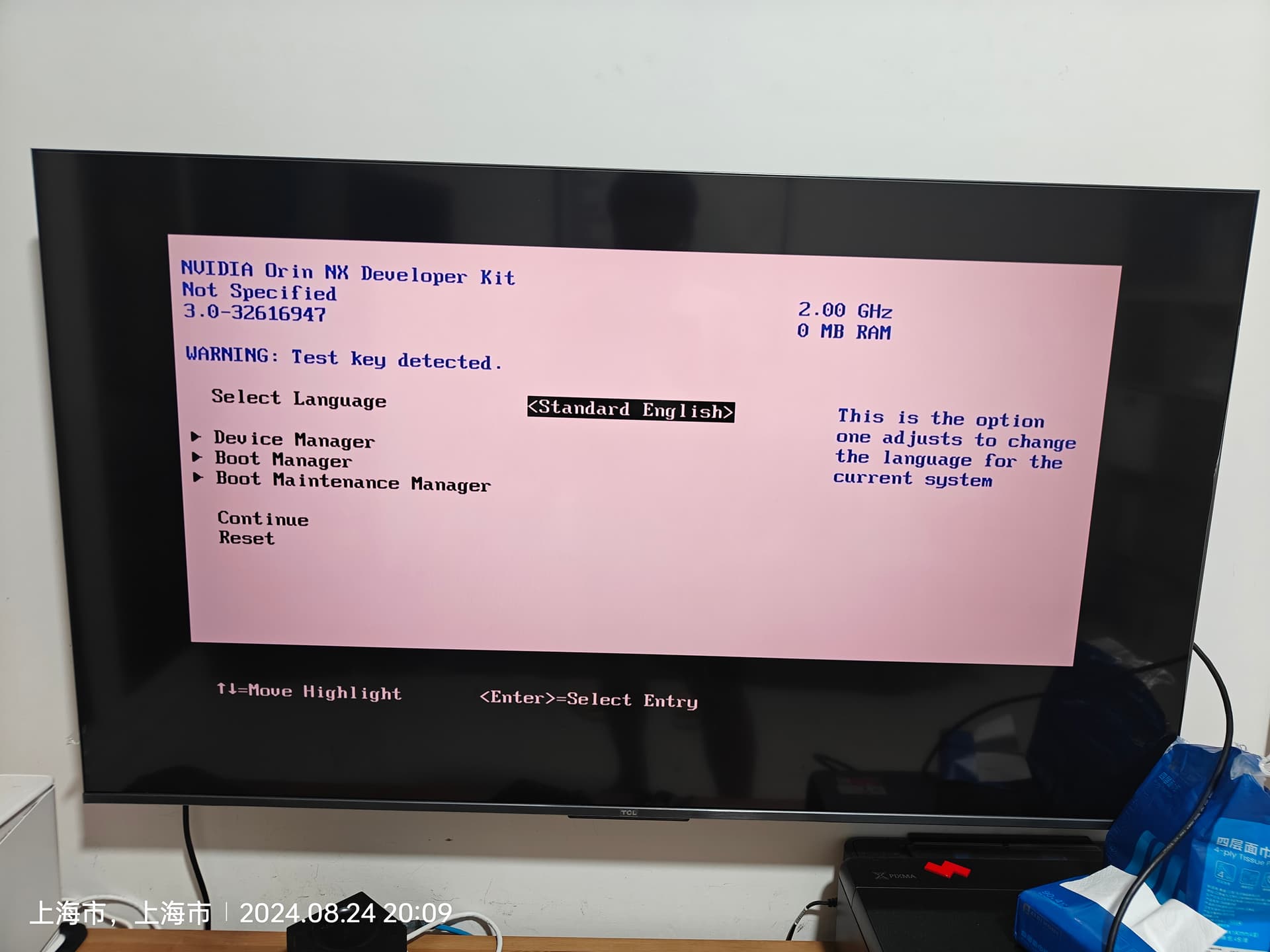

My Jetson orin nano cannot started, it shows a warning of Test key detected, waitting for help , many thaks

i bought this in middle of 2023, the SD immage was working in the last boot many month ago. I remember that i used try to use flash my nvme drive with NVDIA offical tool SDK manager, but failed. Last week I want to power it up with the lastes image flashed to the SD card, but did not works. I also tried to connect this device to my ubuntu 22 laptop via usb c, but also not detected in SDK manaher
Your host PC can only detect jetson when it is in recovery mode in this situation. Please short the REC pin first to make it into recovery mode.
many thanks to your quick response, short rec pin to where or which pin, to battery or ground? sorry that if my question is to simple
Please refer to the “force recovery mode” section.
Refer to the Developer Kit powered off or Developer Kit already powered on case as your board is not able to enter terminal.
Many thanks, my issue was solved indeed by recover mode, i upload a picture shows how to short cut in case helpful for others
