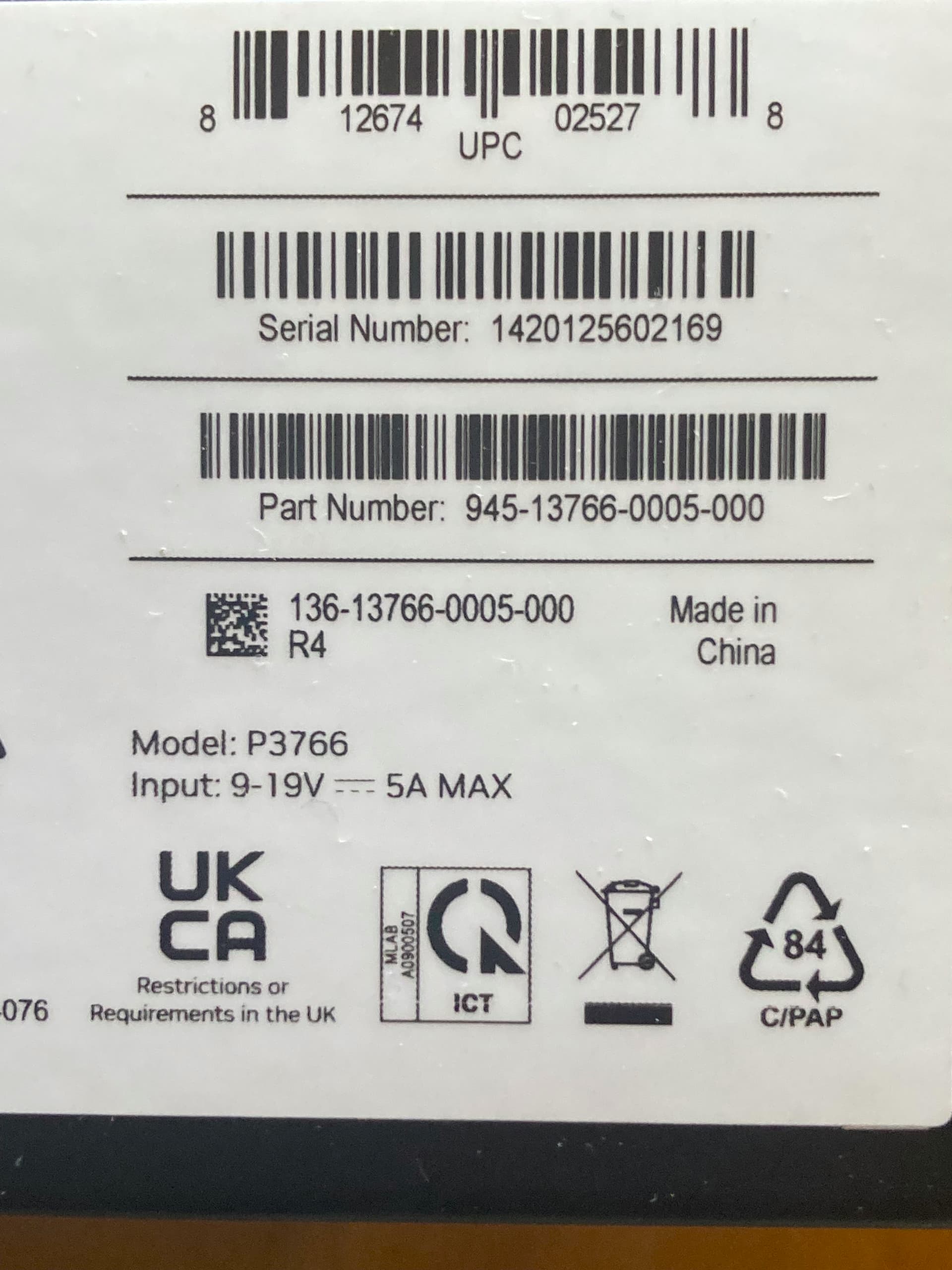

  • The board does not power on, no LED lights or signs of activity.
  • I’ve tried multiple power sources and cables — no change.
  • The issue started very shortly after first use.
🔹Device details:
  • Serial Number (SN): 1420125602169
  • Part Number (PN): 945-13766-0005-000
  • Model: P3766
🔹Supporting info:
  • I have already contacted NVIDIA support (case handled by Dan), and was advised to post here so that the technical team can confirm whether the board qualifies for RMA.

Did the Orin Nano come with a power supply? Usually there is a possibility of powering over a barrel connector or one of the USB ports. There is in fact a jumper when powering via the barrel jack, and if you try to power through that without the jumper it would appear completely dead. They do normally have an L.E.D., but the fan itself does not normally run unless there is heat.
