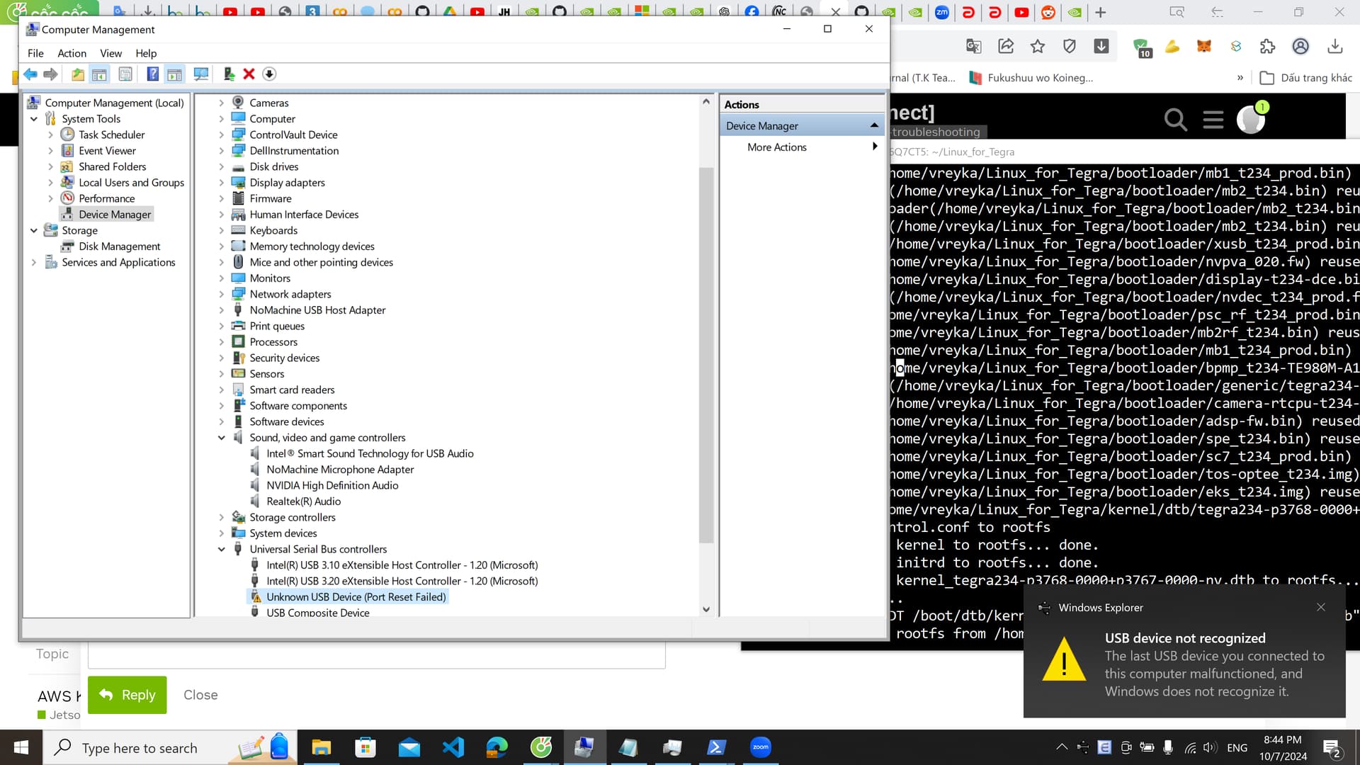

I have fixed the autosuspend problem mentioned above by using this post POST. However, i encountered another problem while flashing :(
You can see that I usbipd has also attached the Jetson back to WSL after reboot. However, the flashing process did not recognize that the Jetson has finished rebooting.
I have also tried keeping the jump pin in for FCM the whole time, but it didn’t work either.
I got this while flashing, seem may the window block the things in jetson
