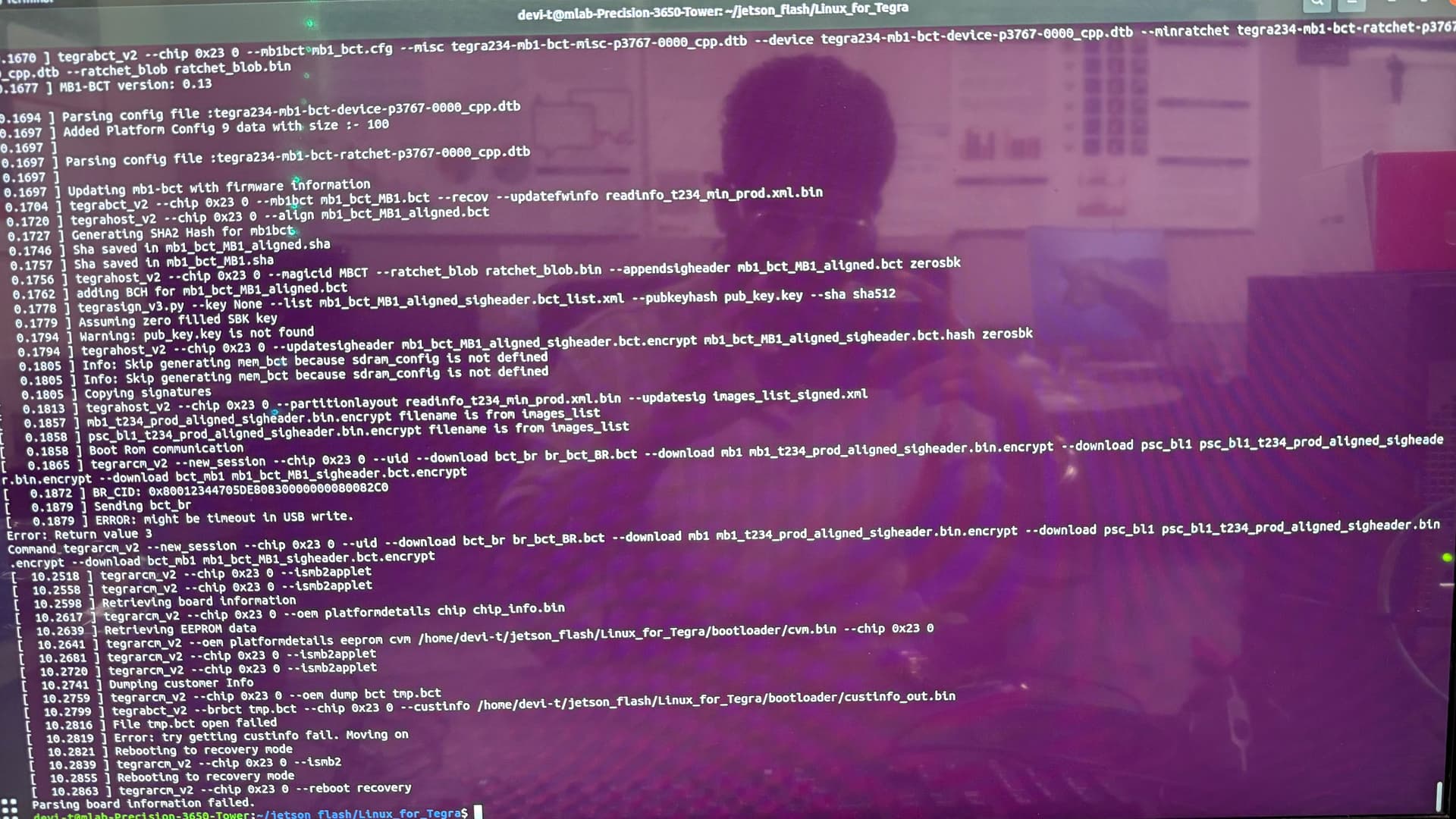

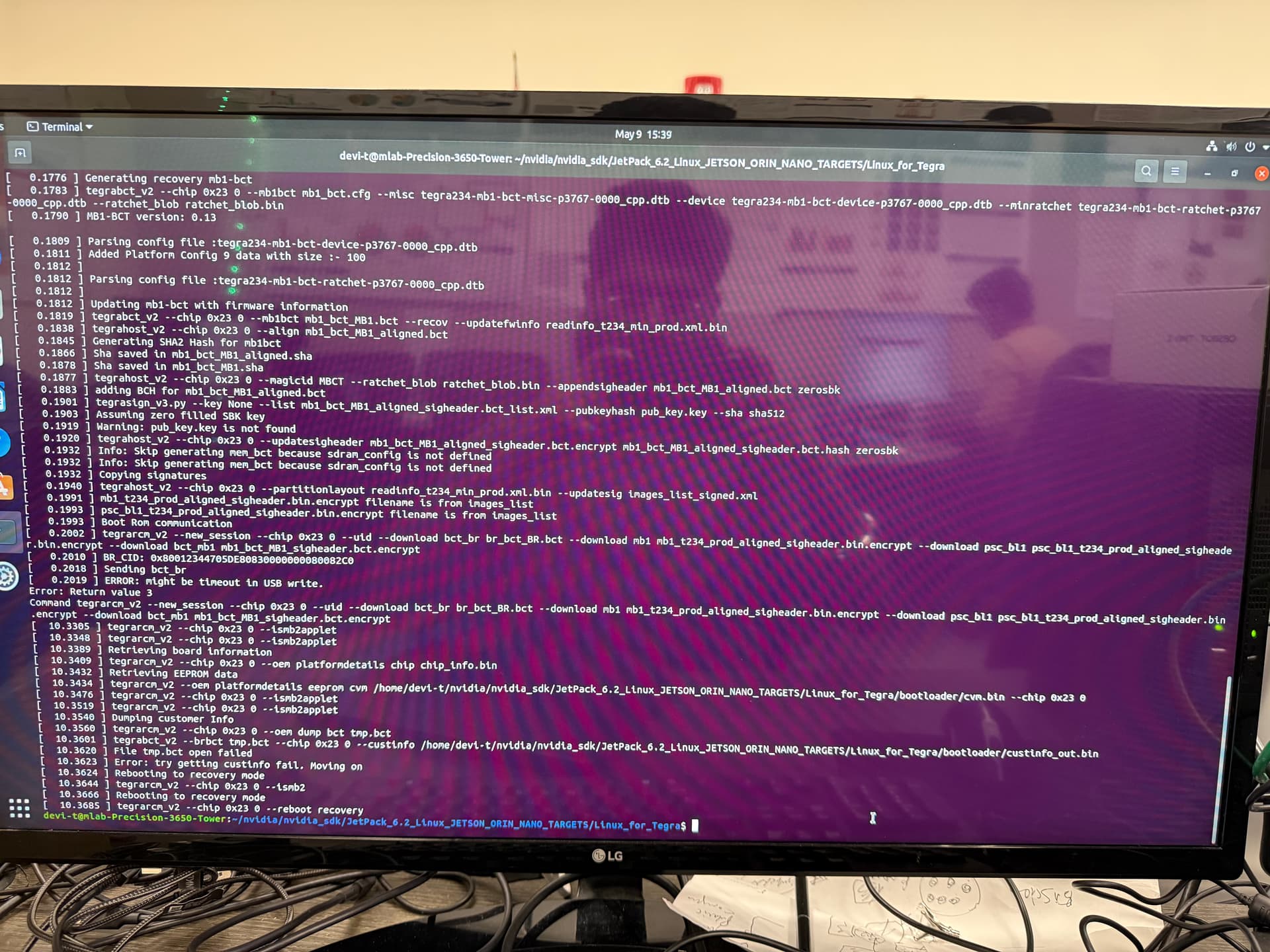

Update: I’ve tried both methods to recover my Jetson Orin Nano (8GB) after the UEFI “Reset Settings” issue:
  1. QSPI-only flash:
sudo ./flash.sh -c bootloader/generic/cfg/flash_t234_qspi.xml jetson-orin-nano-devkit internal
  • This failed with Error: failed to generate images and tegrarcm timeouts.

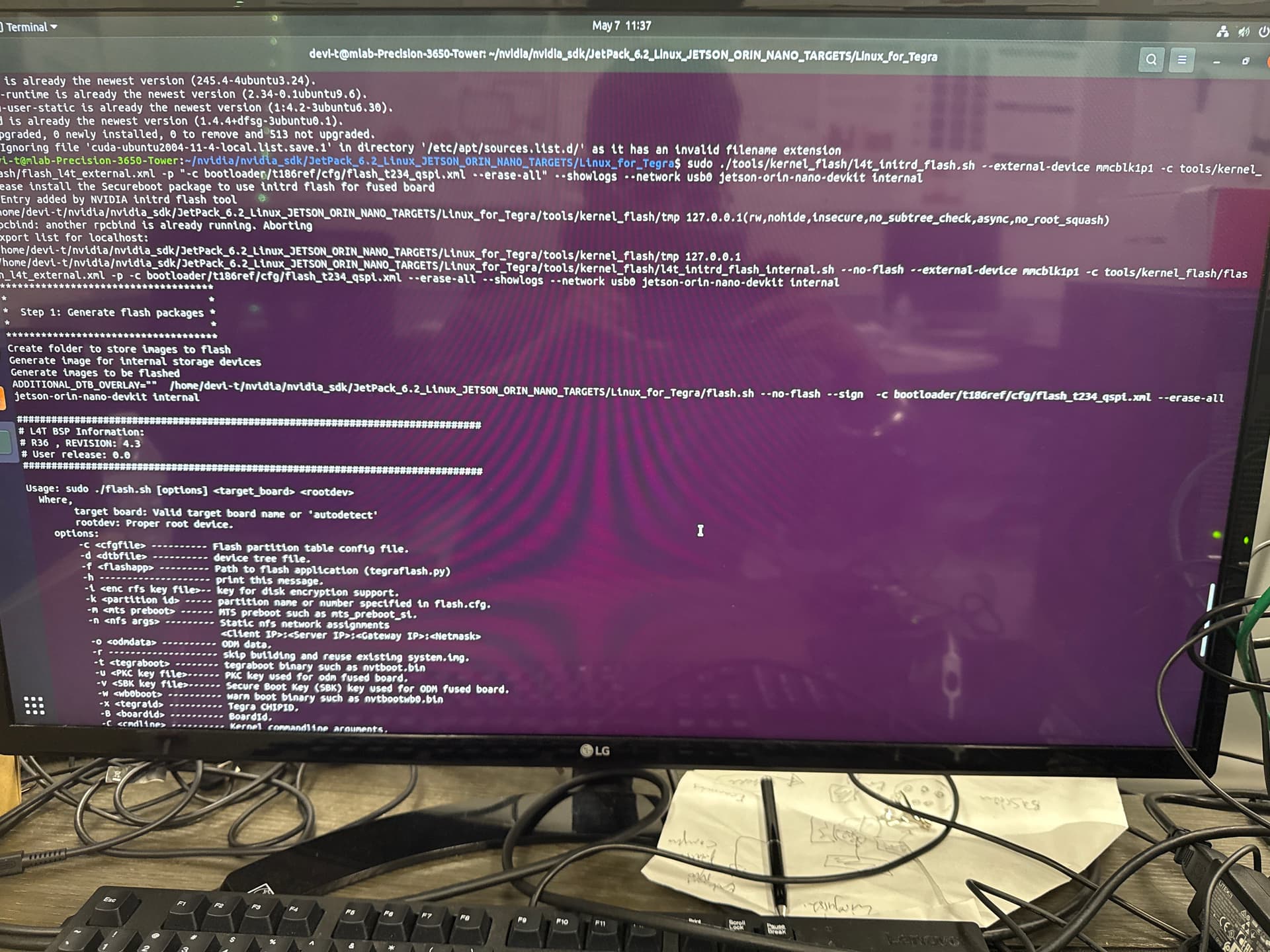

  1. Full flash (QSPI + SD card):
sudo ./tools/kernel_flash/l4t_initrd_flash.sh --external-device mmcblk1p1 \
  -c tools/kernel_flash/flash_l4t_external.xml \
  -p "-c bootloader/t186ref/cfg/flash_t234_qspi.xml --erase-all" \
  --showlogs --network usb0 jetson-orin-nano-devkit internal
  • This also failed. The system couldn’t find /dev/mmcblk* and returned multiple timeouts and board info errors.

Would you like help isolating the exact cause of the tmp.bct open failed or generating the image failure? It’s usually recoverable.
Hi:
Failing on QSPI flashing is strange.
Please power cycle the Nano board and try again. That should fix timeout in USB write issue.
Also, please share serial log for debug. Ref

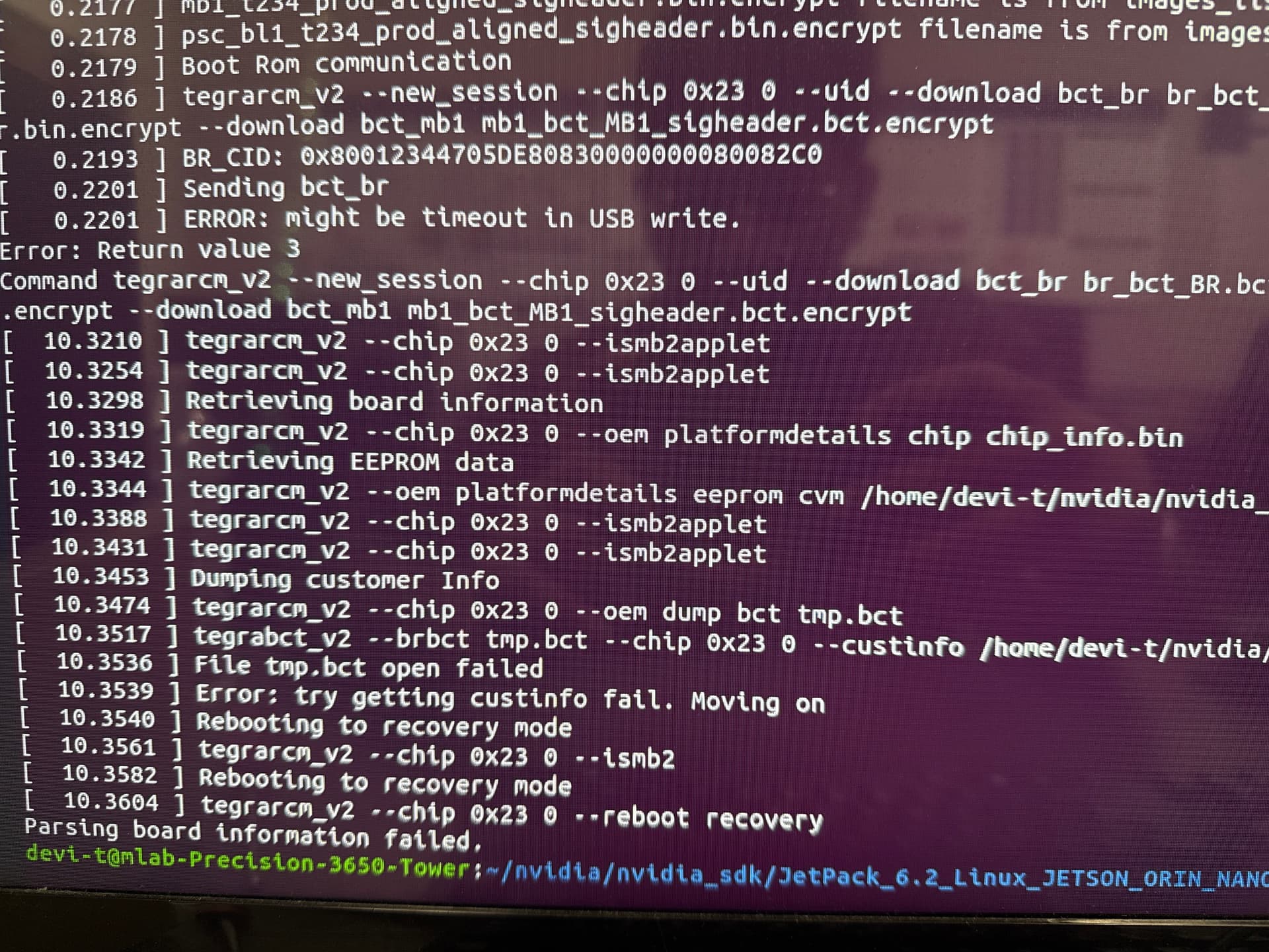

Hi, thanks again for your help.
I’ve tried the suggested steps power cycled the Jetson Orin Nano, reconnected everything, confirmed it’s in recovery mode (lsusb shows 0955:7523), and used both l4t_initrd_flash.sh and flash.sh with JetPack 6.2.
Unfortunately, I’m still getting:
ERROR: might be timeout in USB write.
Error: Return value 3
Parsing board information failed.

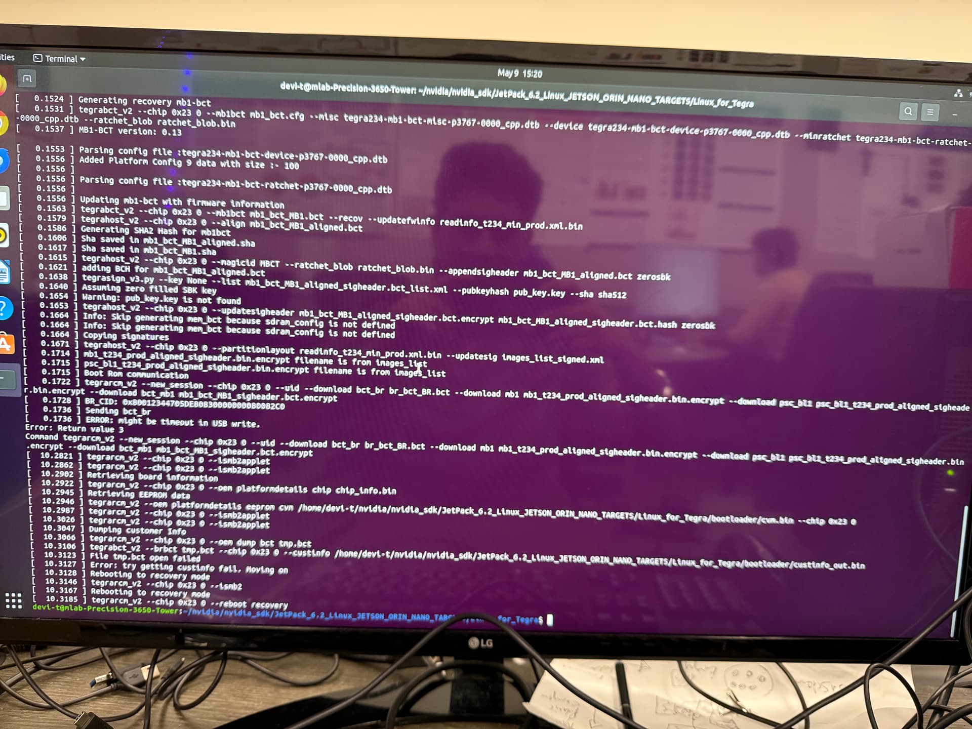

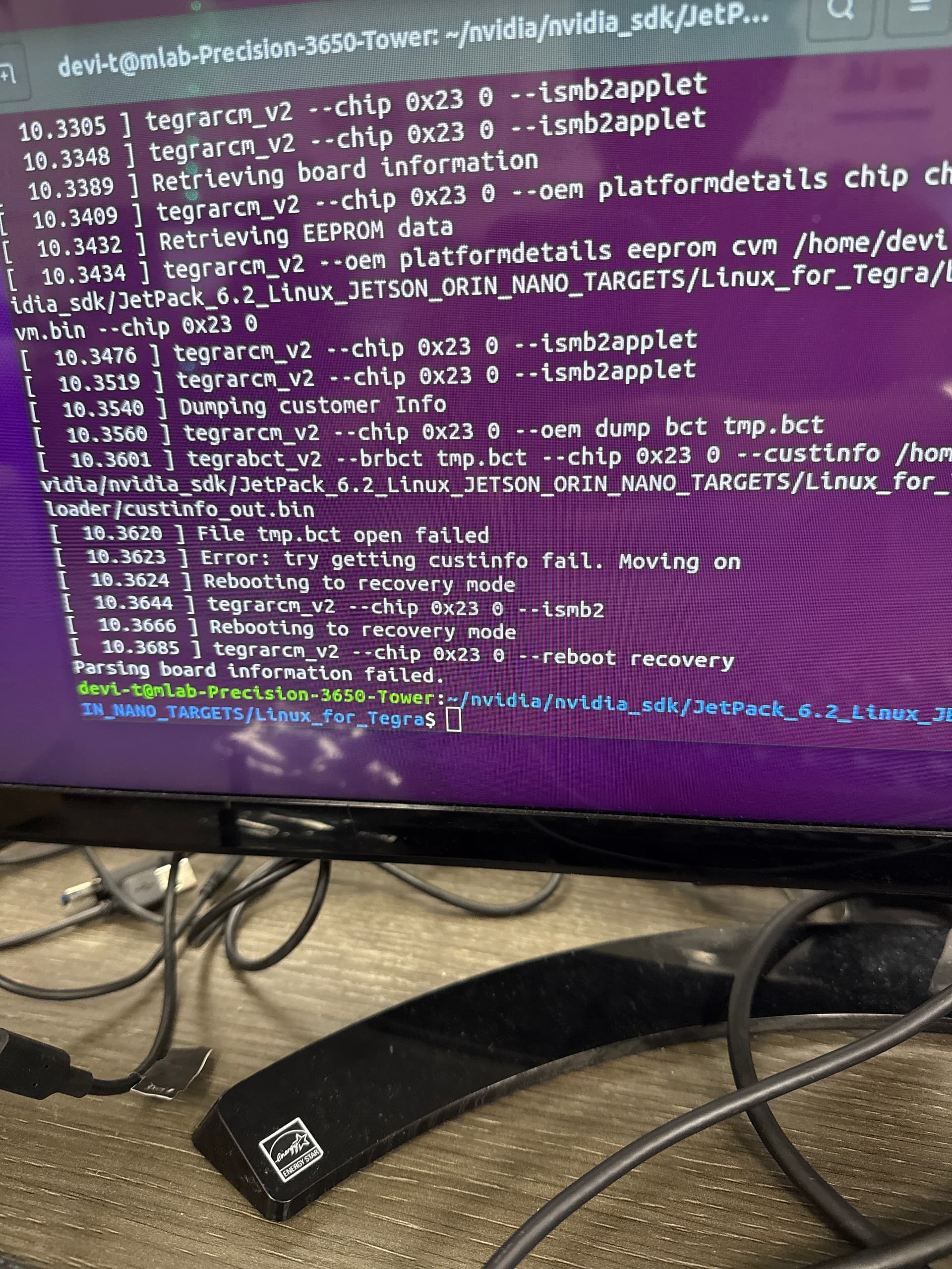

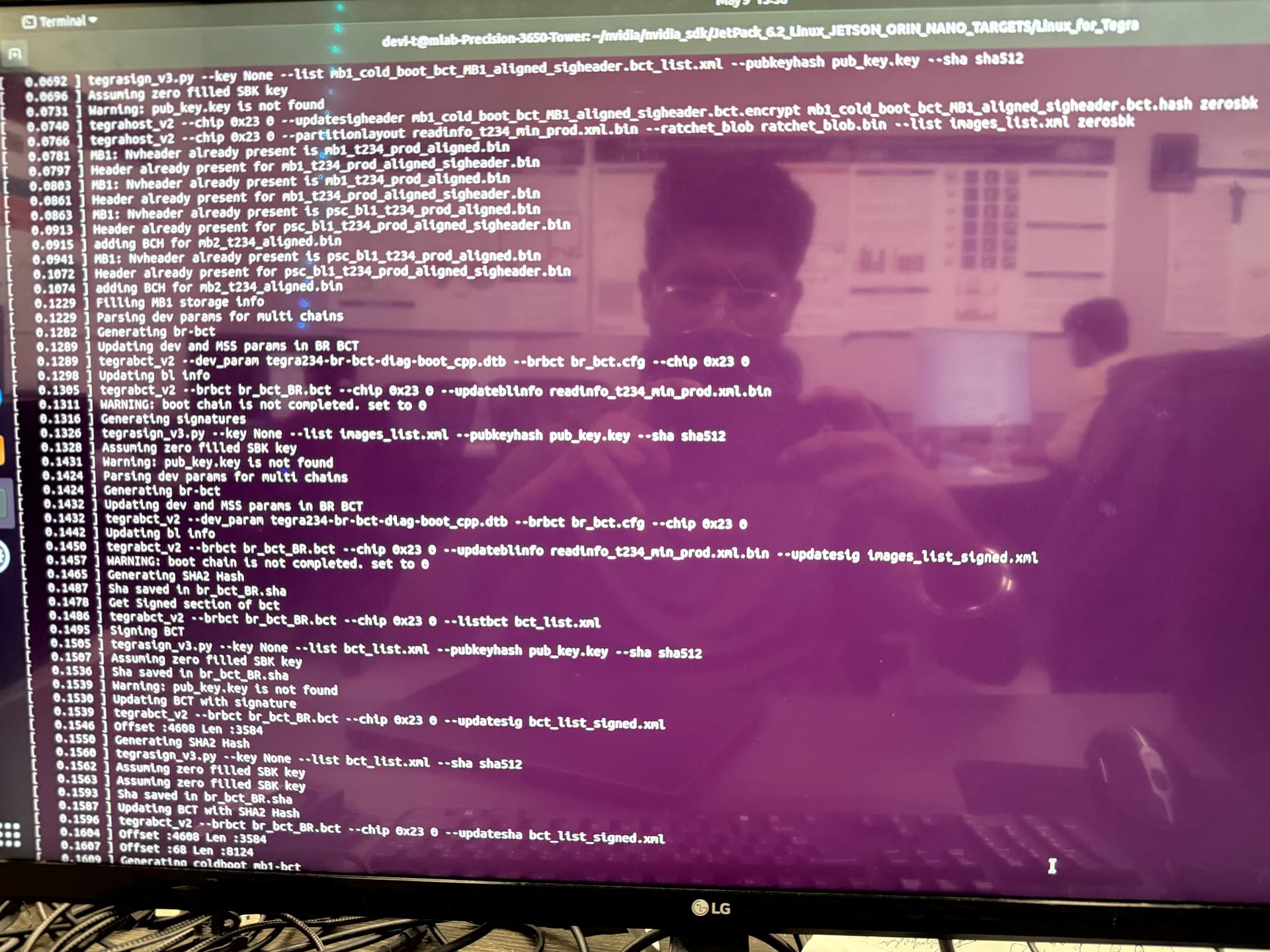

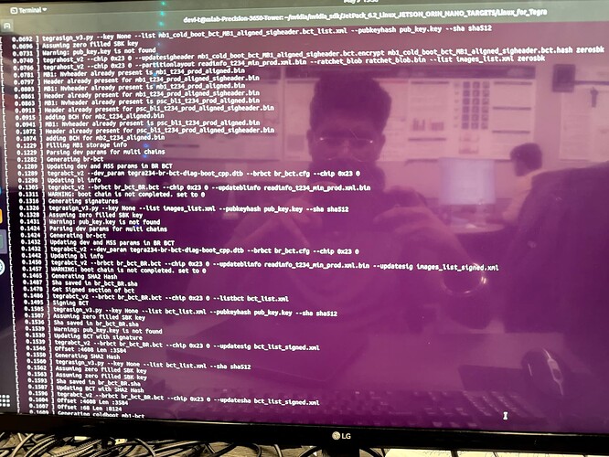

Thanks for the clarification. I removed the SD card and reattempted flashing with JetPack 6.2 using the command you provided:
The board was in recovery mode, but I still encountered the same USB write timeout issue. I also power cycled the Jetson and used different cables, but no success.
I’m attaching the images of logs captured during the process. Please let me know if you need further info or if I should try flashing JetPack 5.1.3 first as a fallback to initialize QSPI.

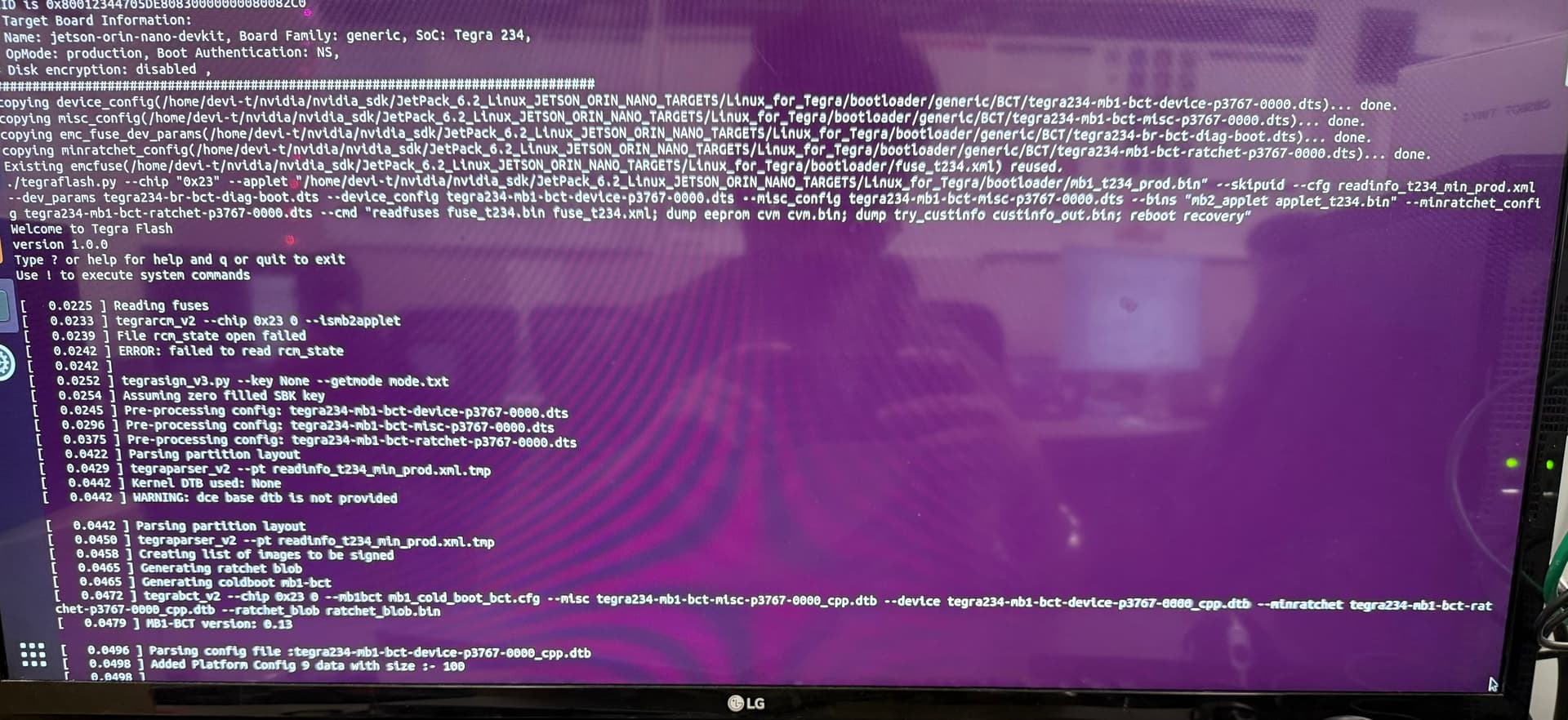

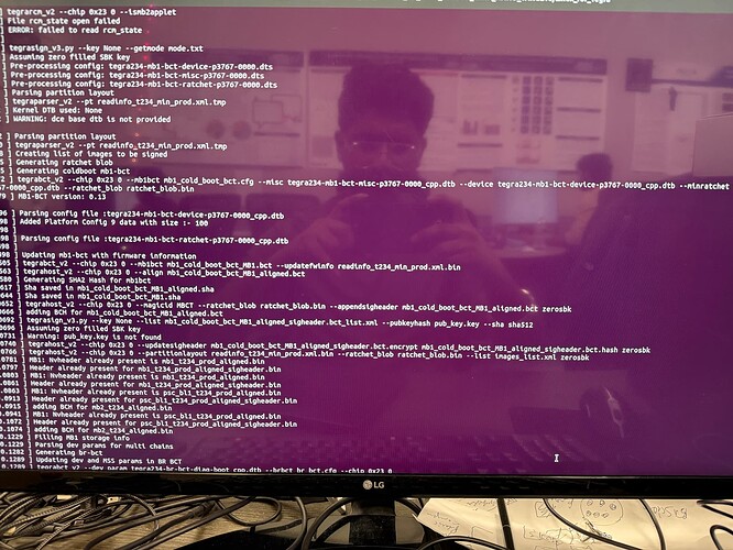

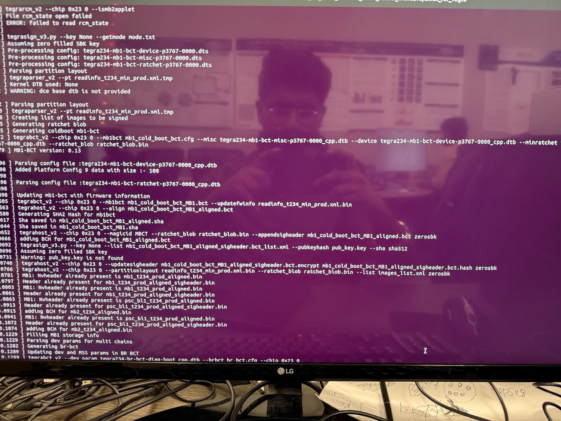

Thanks for the suggestion. I followed the steps to manually set up the flashing environment using the BSP and Sample Root Filesystem from the download center. I ran sudo ./apply_binaries.sh successfully, and then attempted to flash QSPI using:
However, the flash keeps failing with a USB write timeout error. I’ve already retried using multiple USB cables and different ports (including rear ports), and confirmed the device is properly in recovery mode (lsusb shows NVIDIA Corp. APX). Still hitting the same issue.
Please try to disable autosuspend on the host PC, though it should be done in the scripts.
Thank you so much for your help and guidance throughout the setup process. Everything is working smoothly now on the Jetson Orin Nano. I really appreciate your support!!!
