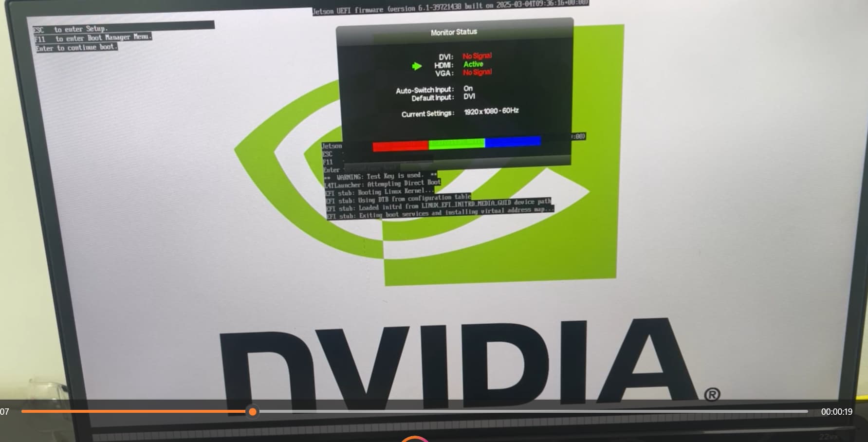

Current Behavior :
  • After booting, the screen is black, and the monitor enters sleep mode.
  • No NVIDIA logo appears, only a black screen.
  • UEFI detects my SSD, and I can select it from the Boot Manager.

Thanks @DavidDDD ! for your help! we tried flashing it again with our previous SSD the one that was provided along with kit from seeed studio.
now we are able to access the gui!
But we are experiencing this problem when we instert new ssd(WD Blue 250 GB SN570 NVMe M.2 2280)
Let me clarify the situation:
  • Use the same method (sdk manager) to flash orin nx with seeed studio carrier board.
    • With ssd provided by seeed studio: PASS
    • With new ssd (WD Blud): Fail
Please correct me if wrong.
Hi @DavidDDD
You are right, With new SSD it fails
